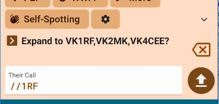

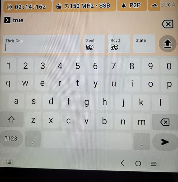

Hi Alan, callsign notes is enabled. I typed the 2 dots which became slashes as expected plus the callsign shortcut. When I hit the send button, the field above the “their call” field changes to the word “true” and after several seconds it and what I entered into the “their call” field disappears and no QSO is recorded. A second press of the send button does nothing either.

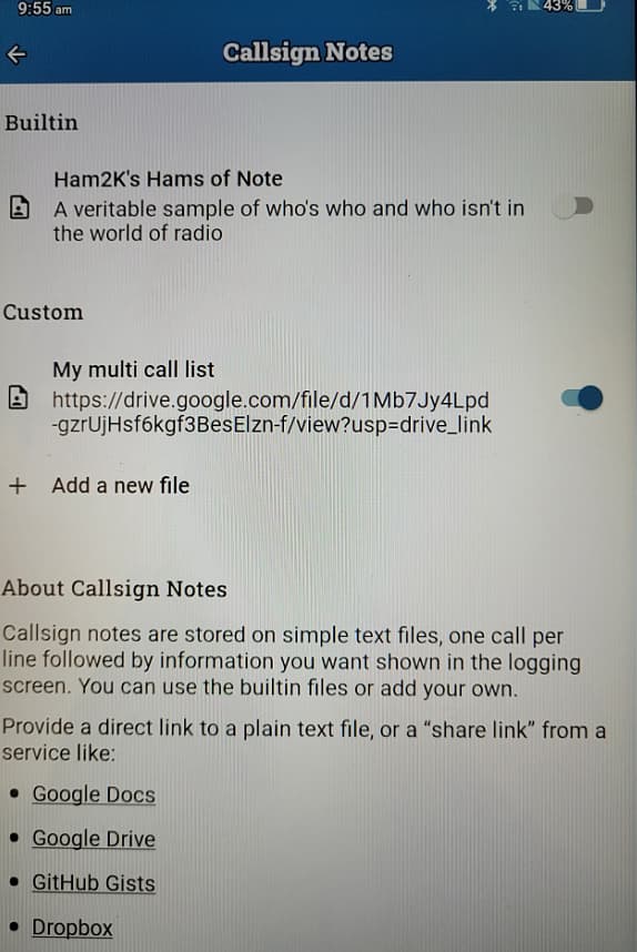

Thanks for going through this with me Alan. The Google link is

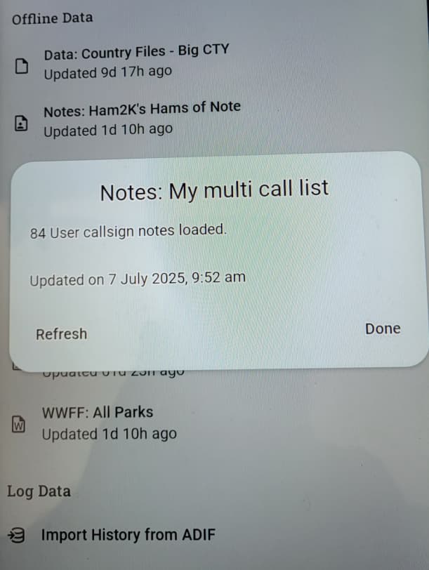

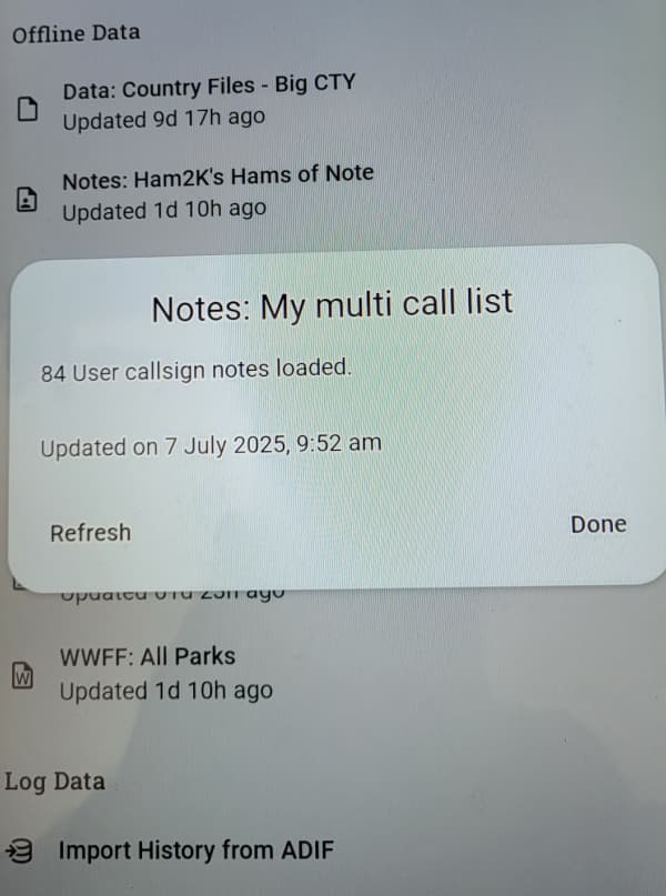

I note that when my file is refreshed, it shows 84 callsigns and has done for each file I have tried.

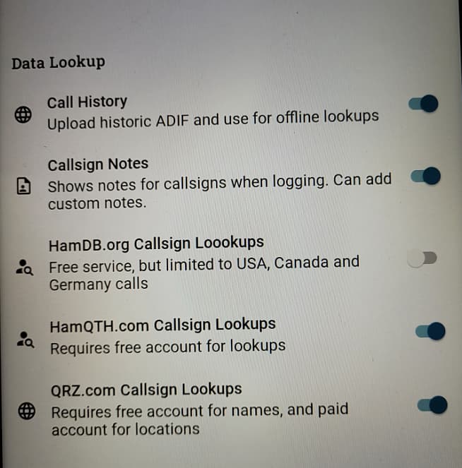

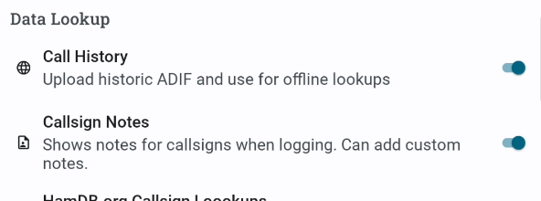

The file works fine either way - have you made sure you have it enabled as per these instructions?
And do you have callsign Notes enabled as a data lookup source?
I had pics of the enabled feature but could not attach more than 1 in a reply.

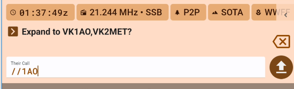

I don’t see your attempt to enter a callsign. When I type …1AO I get this
I also see you have 84 callsigns downloaded now so we are not talking about the same file as you sent me…
I am at a loss to find the problem Alan. I created a totally new text file with one line from scratch with a new link but PoLo still loads something with 84 callsigns in it.

the file you sent me looks awfully like a file that has 84 characters.
I have suspicions this is a character set issue.

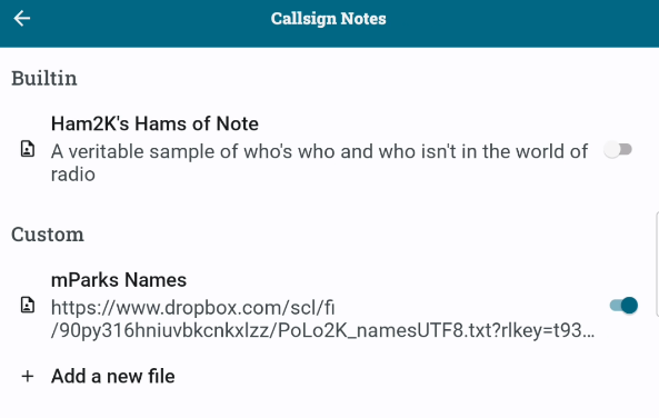

I will send you a link of mine for you to test

I’ve sent you message Albert
Callsign Notes files stored in a Cloud service need to be granted free access as a public resource or shared with everyone.
