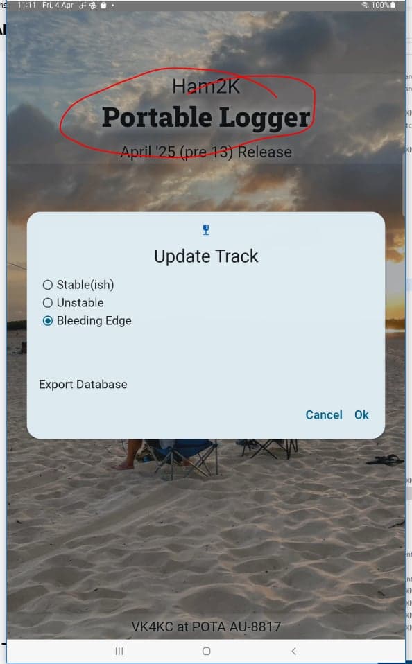

you can quickly tap on the “Portable Logger” part of the title (you should start tapping before it appears) and you’ll get an “use in case of emergency” dialog that lets you change update tracks, and backup your database.

The current workaround is a separate version of PoLo that removes a couple of features (Maps, in particular) and allows it to fit in a smaller RAM footprint.
The app is not yet available directly in the Play Store (they require a minimum test period we have not met yet) but you can join the test by emailing us at help@ham2k.com and indicating the exact email you use to sign in to the Play Store.
