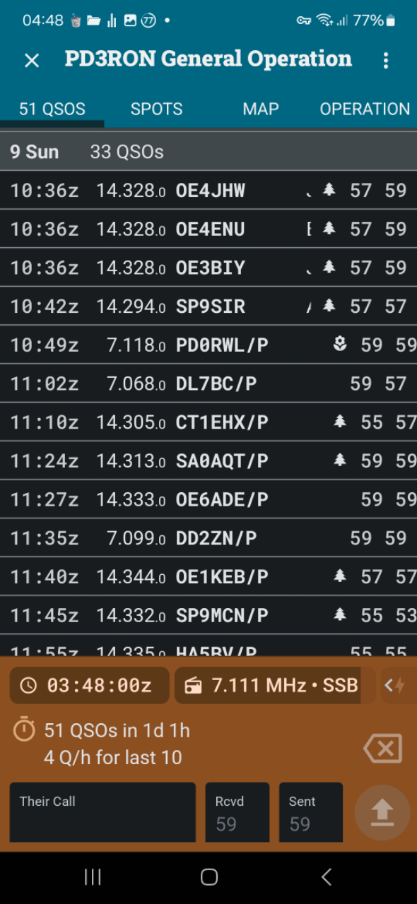

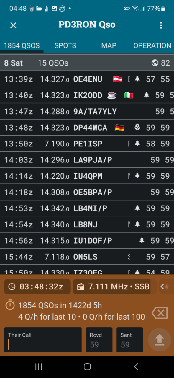

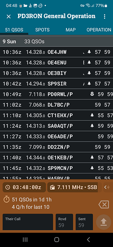

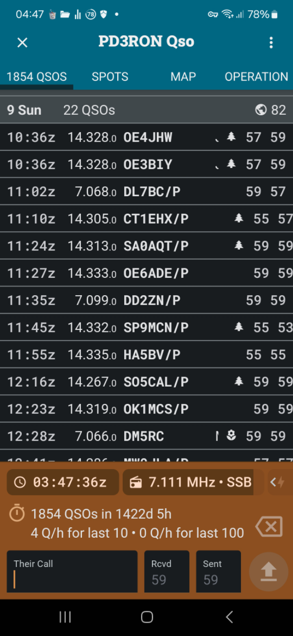

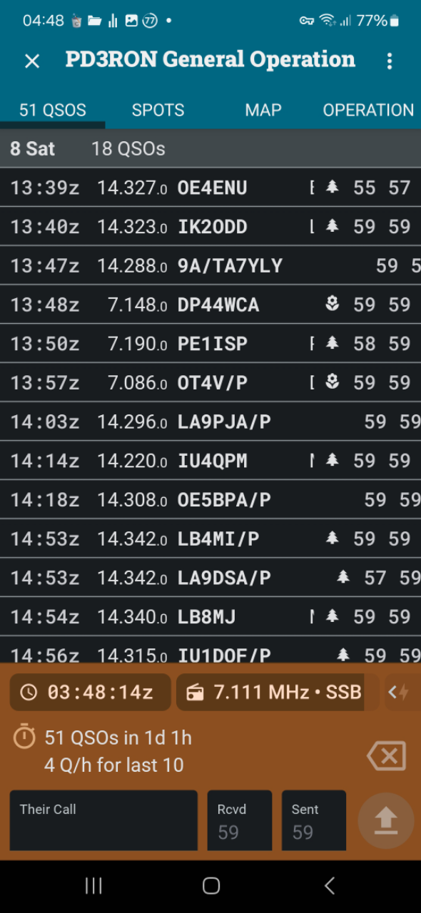

Hi,
This is easier to make with laptop then with phone :blush:
Daily log saterday main history log
Sunday daily log Sunday main history logbook
Please see screen shots from logbook.
Left side is my .adi from a day or weekend, at the right you have my total logbook( counter is not correct also log4om shows 2863 qso’s)

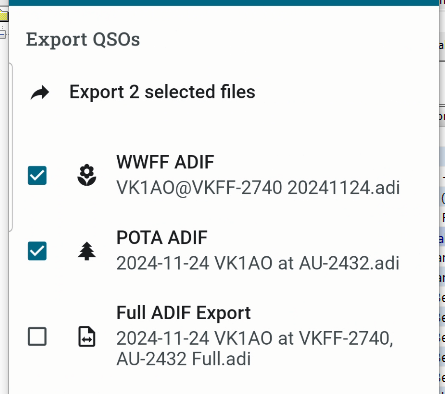

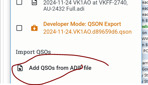

Sorry Ron - there are no screen shots attached. Can you try again?
And also I do not know exactly what you mean by “main history”

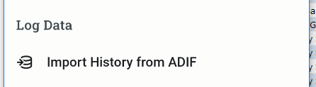

I know PoLo Operation Log
where you can add QSOs from an adif file
and I know PoLo History import.
Can you clarify again which options you are using please?
There is also the export QSOs option which exports your operation to import into other programs e.g. Log4OM
You do refer to 2863 QSOs. Do you have an Operation (i.e. just one operation with this number of QSOs? Are you working only with one operation all the time?
I ask because the logic of PoLo is to think in terms of shorter finite “operations” e.g. Activations, for one UTC period.
There is some occasional interpretation that PoLo is meant for one never ending operation and this can cause confusion on how dupes etc are calculated.

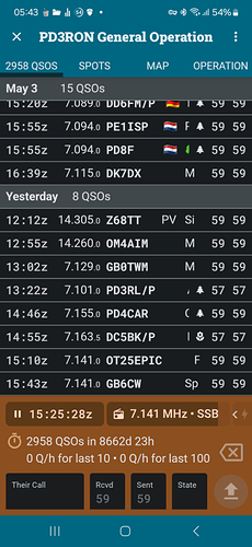

Hi,
Problem is still active.
I made yesterday 15 contacts, after import adif it’s showing 9 lines.
Please see added screenshot from yesterday and adif file
Thanks and enjoy the hobby :studio_microphone::studio_microphone:

Interesting.
I see 15 and 8 on screen and I see 14 in the ADIF file. Can you reconcile them? Can you tell me which one of the 14 in the adif file is not imported?
I don’t see 9 anywhere.
More interesting, though, is seeing 2,958 QSOs in a single General Operation. I have to wonder what benefit you think there is to having a single operation like this with so many QSOs in it. I mean, it’s not exactly searchable or offering any way to interact with it. Can you explain the benefit?
Hi,
14 qso made yesterday, only 8 are showing at day 10 may.
2958 qso are total.

If I take a quick look, those I miss
