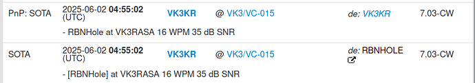

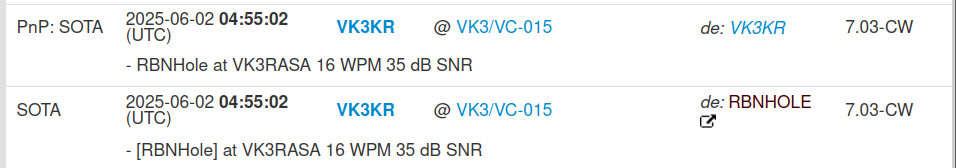

However, Internal spots forwarded to other clusters by ontheair do reflect back into the External spots table. But on the website all spots are clearly marked showing the cluster from which they originate. The same behaviour is seen for duplicates showing up on multiple external clusters. E.g.:
You can view this as a feature (seeing which clusters have picked up each spot) or a bug. If anyone complains, or if I find myself with free time and unoccupied, I’ll put in some de-dup code in the web page view. That would show each spot only once, but list all clusters that report it. But as each cluster reformats spots in different ways, the de-dup is not the case of a simple A==B comparison.

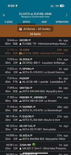

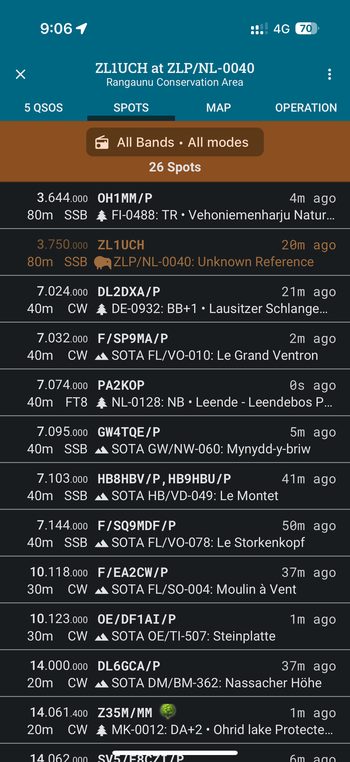

Thanks heaps for all the hard work getting to this point. I went out in the dark and stormy weather tonight to activate one of my locals. It worked great! Spot publishing worked perfectly. Was unable to try park to park as I couldn’t find anyone else silly enough to be out in the dark.
Only issue I found was the rendering of my own spot showing unknown reference. I checked the spot and it was logged correctly.
