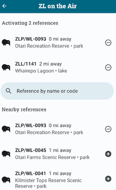

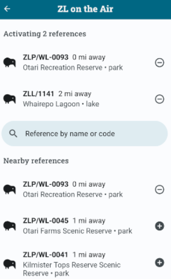

Hey @zl4nvw. I’ve got the basics up and running on my dev system. I’ve used the reference information here: https://ontheair.nz/assets/assets.json
