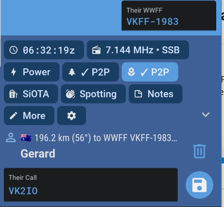

Park to Park contacts are entered into the QSO via the entry fields
and will show in the QSO list with relevant park symbols.
PoLo also provides for checking and reference entry via the use of the Spots which will take the references aggregated in the spots and fill the QSO details in for you.
This example will refill the QSO for you
Tapping on this spot will fill in both the references for you:
Also, the exports for each of the programs do not include anything not required by that program. So the POTA export does not have any WWFF data, and viceversa.
The “Full Export”, meant for your own use, should contain all that information combined.
