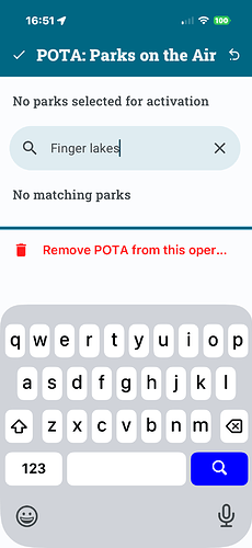

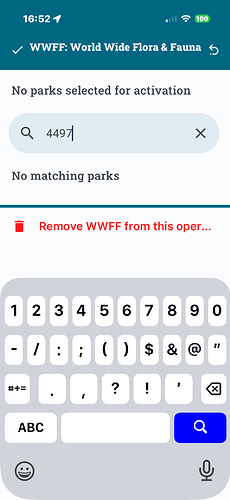

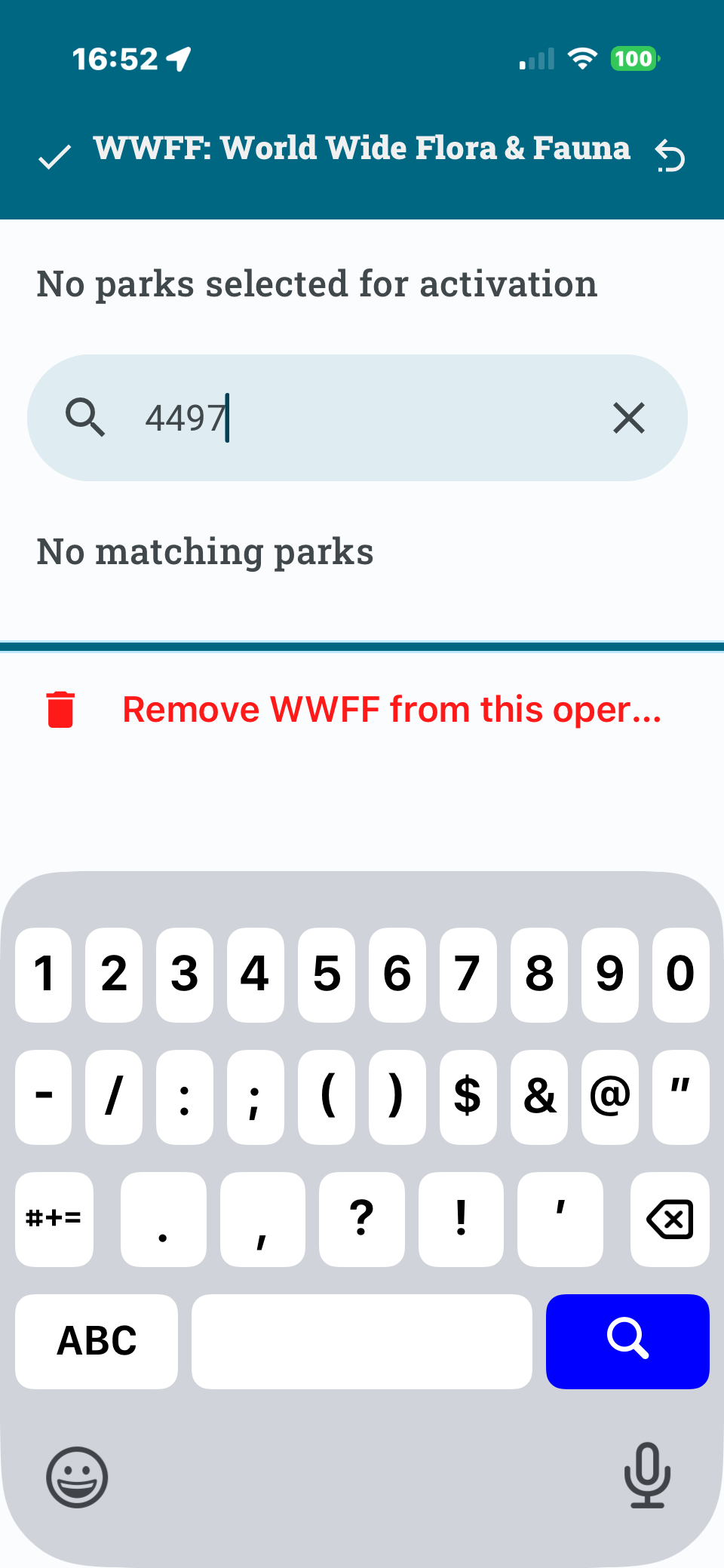

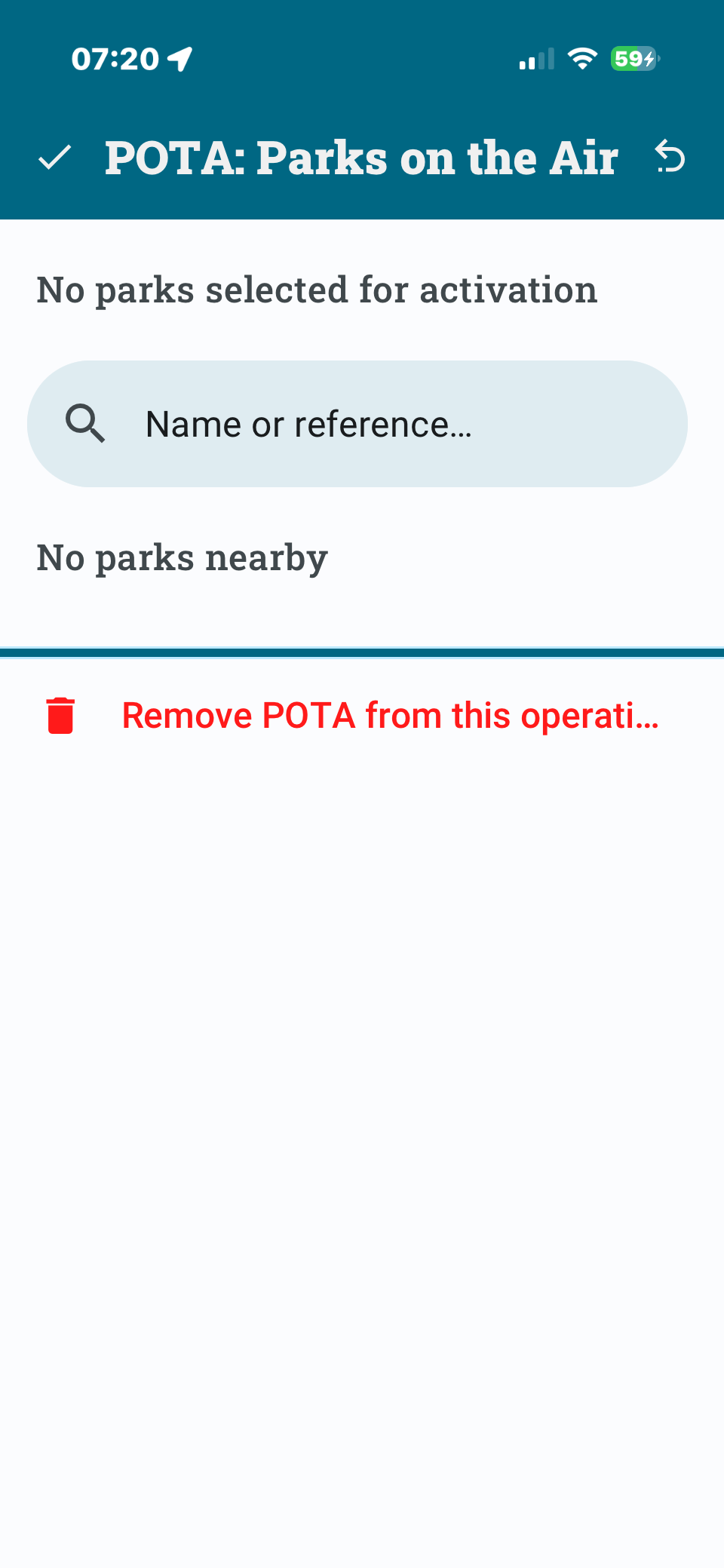

Good morning, Alan. Thank you for clarifying. Below are two screenshots that I hope provide context. It’s not limited to just WWFF. LLOTA and POTA behave the same way.
Have you got your gps on and granted permission to PoLo?
If you start typing a park name do you see a list building?

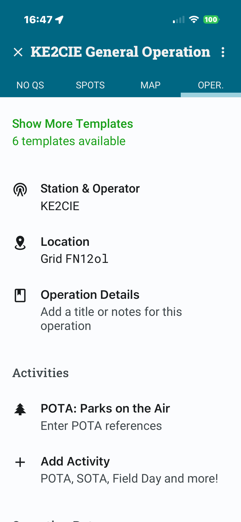

Alan,

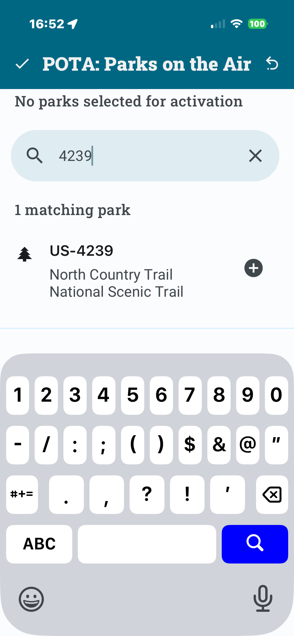

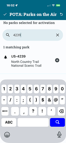

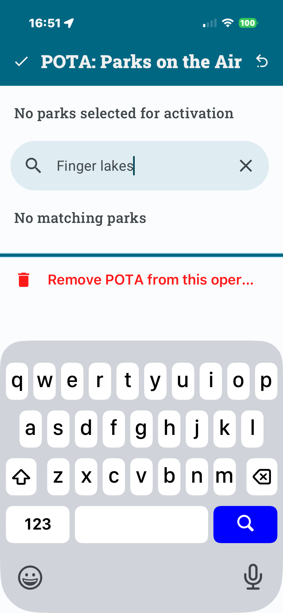

Thank you for all your help. My grid square populates as shown in the picture below. Nothing happens when I type a park name in POTA. But, if I know the park number it will show me the park in POTA (see picture). However, in WWFF it doesn’t recognize either the park name or number. I did an activation last night so I could load the POTA parks because I knew the numbers but I couldn’t load a WWFF park.
Can you go into the Data Settings screen and refresh the data files for POTA and WWFF? The problem you’re having can be explained if the app does not have park data for some reason.
Also, side note, when searching for parks you can search by name too… no need to use numbers.
Thank you very much, sir. That did it. I am very grateful to both you and Alan for your help. I love Polo.
