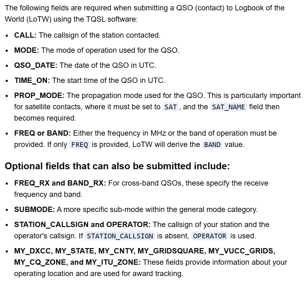

YOUR grid is set in the operation - not the More tab. This value is exported as MY_GRIDSQUARE. It’s THEIR grid that is stored in the grid on the More tab.
The more tab is the only place atm to store THEIR grid for submission of awards where you need it exported in the ADIF export file.
Storing a grid in the exchange may be faster for entry purposes but you would need to manipulate the field columns in ADIF master prior to upload. e.g. by changing the column header from Exchange to GRIDSQUARE
If you have a QRZ paid subscription and use lookups, their grid will be populated for you. In cases where THEY are not at the location of their QRZ account, you would need to edit THEIR grid on the more tab. But, of course, any attempt by you to submit a grid for THEM will be overwritten by them when they submit their log. They are the authority of their grid, you are the authority of yours.
The bottom line Mark, is that anything you do to record THEIR grid is pretty much a waste of time other than something interesting in YOUR log.
It’s what they eventually give you in their log submission that goes to any grid award.

Imagine this scenario. I am an unscrupulous operator. I have made 100 contacts with operators who always QSL via LOTW. So I put aside the next 100 QSOs and identify 100 grids I need for a grid award.
So I put those 100 grids into the 100 QSOs and submit them. If that’s all it takes for me to get those 100 grids, then something is wrong with the world. Wouldn’t you agree?
And there is no matching of grids going on at all. I still get a QSL from LOTW. In fact a GRIDSQUARE (i.e the grid you think THEY are in) field value is just discarded by LOTW. Only MY_GRIDSQUARE is recorded.
