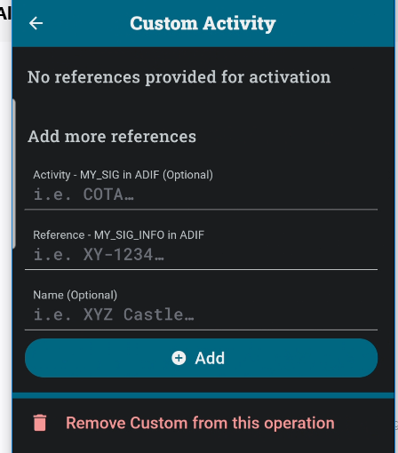

You can, of course, always use the Custom Activity which is available in PoLo.
Enabling Custom Activity and choosing it for an Operation is already prompting you for castle details.
