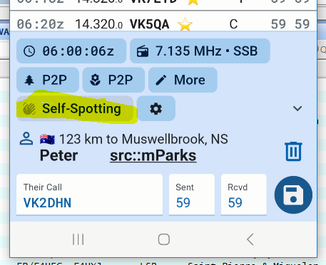

I know I suggested this before so apologies for repeating myself… but when you click a contact to edit, the “Self Spotting” button is not active as you would expect in the current model
But if instead, the button was active with the text “Spot VK2DHN” (in this case)
I would not find any confusion in this meaning that I can spot this contact.
Hmm, maybe I was so focused on making this automatically that didn’t stop to think about this.
I’ll take a stab soon. (and feel free to keep reminding me about this idea if I forget)
no probs - I think this idea will have minimal impact on the screen design and all the info is right there in the edit screen to do the spot other than a comment.
