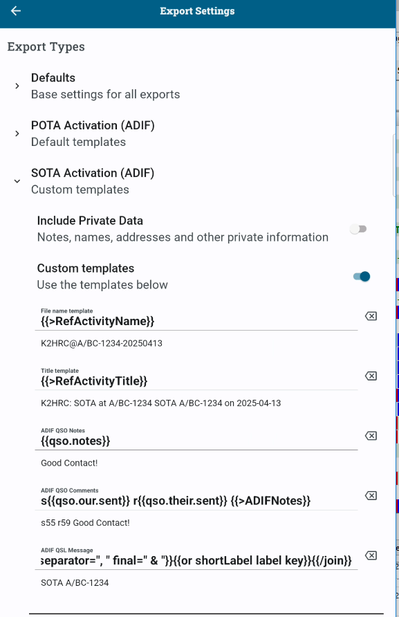

You can customise the comments and notes as you wish with the export templates.
Thanks, Alan

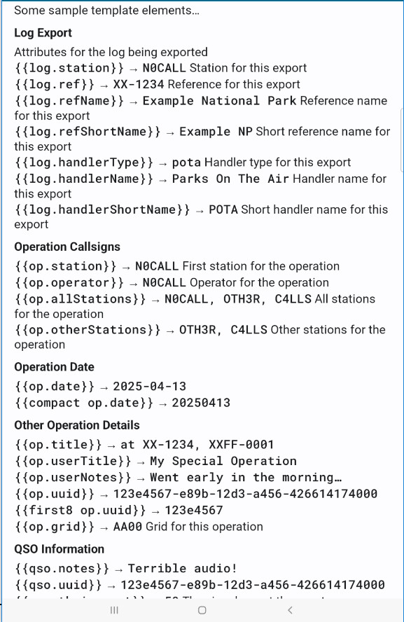

I am unsure where you get a PDF version of the manual. The source of which should be the online version here.
That said, documentation for an application which is under heavy development like PoLo is always lagging well behind the changes being implemented.
The export settings provides some examples of available field values. At the moment you need to experiment a bit to get what you want.

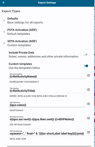

But your snippet from “Export Settings” was helpful. I had to print first the full set of variables and some basic examples for each from the “Export Settings” section, to have the syntax visible for me to alter the “ADIF QSO Comments” on the same device.
Now on experimenting! I’ve tried two things to alter the default setting for the “ADIF QSO Comments” line:
  • One was to append {{qso.their.refs}} after the reports, to export also the partner reference resp. references. That failed, it doesn’t run. I had QSOs with partner SOTA summits and partner POTA parks, even a 2-fer, but nothing is displayed in these cases.
  • A second try was to clear the field content to have NOTHING on this line, i.e. no signal reports and no display of possible notes. That failed, too. I could not empty that line. Delete the variables didn’t help. Entering 1 blank (space) didn’t help, either. I had to enter 1 real sign like “.”, then only the “.” was displayed, but that was not what I wanted.
So, how do I delete correctly the variables from the “ADIF QSO Comments” line to have the signal reports away and replaced by nothing? How do I display all available partner references?
I am – probably like many users – not used or not professional enough to study/research code details at Github or other developer places. So I am always happy to have a comprehensive type of manual to alter such coding details. Or a hands-on explanation here in the user forum. Thanks for your support.

Like Alan said, we added full customization of templates for each different activity to let you better suit your needs.
The April release is coming in a day or two and fixes a few of the bugs you mentioned.

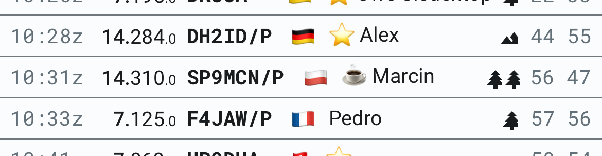

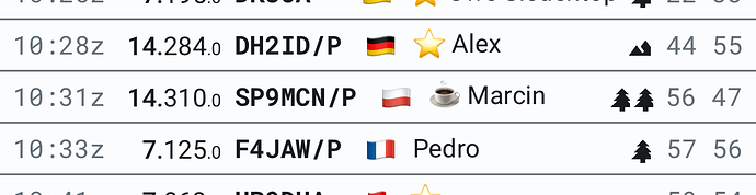

Maybe I was not clear enough. Many here use VK port-a-log that displays the partner’s name if available from the names source and saves it even to the comments together with the reports if you wish that: “Alex s44 r55”.
I see a similar or same name display here and think that this can also be displayed and saved to the ADIF aside the reports like VK offers.
73, Markus
I know what you mean Markus. Neither the operator name nor the name from the names file can be manipulated like that. The names file is purely a display. It is not passed into the storage file.
I maintain my names file in a similar way to the way I manipulated and managed my names file in porta log. It has 77k names in it and is just for display and assists me to confirm the caller.

The name field is available under the “More” secondary control (the buttons in the same row as time, frequency, p2p, etc)
All QSO fields should be available on that screen.
You can change any value, go back to the log and then press “Save” on the bottom right corner and it should be preserved.
Thanks, Sebastián

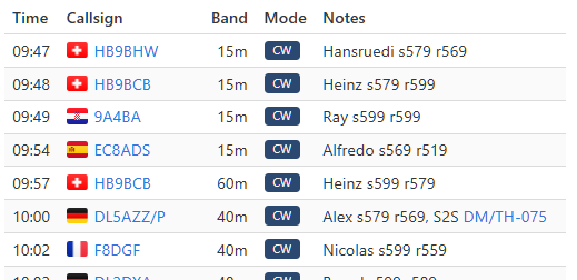

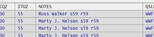

I could follow that. I could change the partner name for a stored QSO and its display changed on the Polo screen to reflect my change. But – as understood from Alan – regardless of how the name is ultimately displayed, it is not possible to write/export it down to the ADIF file as shown in the following example together with e.g. the sent/received signal reports (as shown below in the log details for a SOTA activation):
But I’ve still not understood the rationale behind the complete unavailability of the partner names for the ADIF export of a log: is it reducing data redundancy (since the names could still be derived later from the callsigns) or data protection or anything else? Or simpler: Why is it “bad” to write e.g. the name together with the sent/received reports to the ADIF comment field?

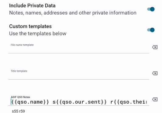

So, in short you are asking for access to a qso field for this purpose?
{{qso.name}} s{{qso.our.sent}} r{{qso.their.sent}}
QRZ returns xml fields fname and name_fmt. The ADIF spec does not have these fields. It has NAME only. PoLo fills in the QSO field name with the QRZ name_fmt and ignores the QRZ fname field.
So first name only may not be ever accessible if we adhere to ADIF specs or do something else to customise which entry goes where which would only suit very few people.
I’ll leave @KI2D to comment on surfacing the {{qso.name}} field for use in the templates. There are other fields not accessible at this time, e.g. DXCC etc.

As to including a variable for the remote operator name in comment templates, you should be able to use {{or qso.their.name qso.their.guess.name}}, but we should provide an easier template expression.

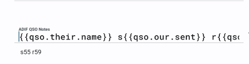

@KI2D I just tried with this
but I only get the reports
their.guess.name does., however, work
As for Markus’s request, it will be the fullname (fmt_name) as reported by QRZ, unless you (Markus) edit each name value in the more tab back to First name of your choice.
