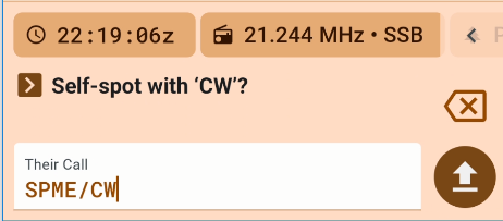

Today, the self spotting from the entry window doesn’t work (SPME/CW). Worked FB yesterday. --n1bs

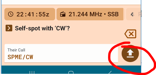

For example putting QRT in the callsign field you can’t hit the enter key on the keyboard or send on the screen to send the spot. Unfortunately I can’t upload a screen recording on here. But here’s a link to it to view it if you want to.
Hitting enter, either on-screen or external keyboard does nothing. The SPME /CW stays in the entry window. Top of the info screen shows SPME/CW with a QRZ button next to it. I don’t believe it did that before. Like it thinks it’s a callsign lookup?
Mind you, it worked yesterday, and I’ve used the functionality dozens of times.
Samsung tablet Android 15.
Split mode or portrait, same thing.

again… what happens when you use the up arrow?
same no action? I do not have iOS to test this. I need you guys to clarify.
You’ll have to use the Self Spotting full action until the issue is resolved.
Yes it’s the same, no action happens. I’m on iPadOS 18.5 on an iPad Pro.
No problem just wanted to point it out and help resolve the issue if possible. Thanks
Yes, same with up arrow. I’m using Android 15.

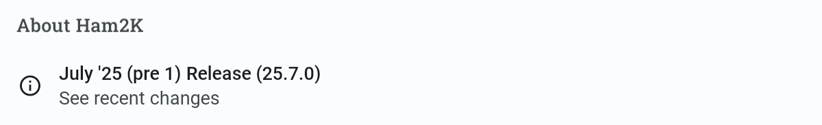

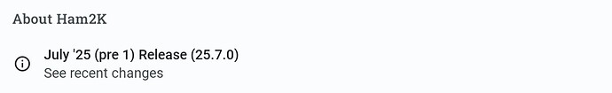

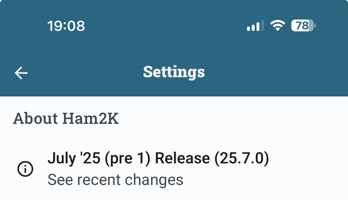

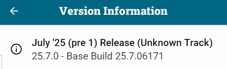

This issue is now resolved in the July release
