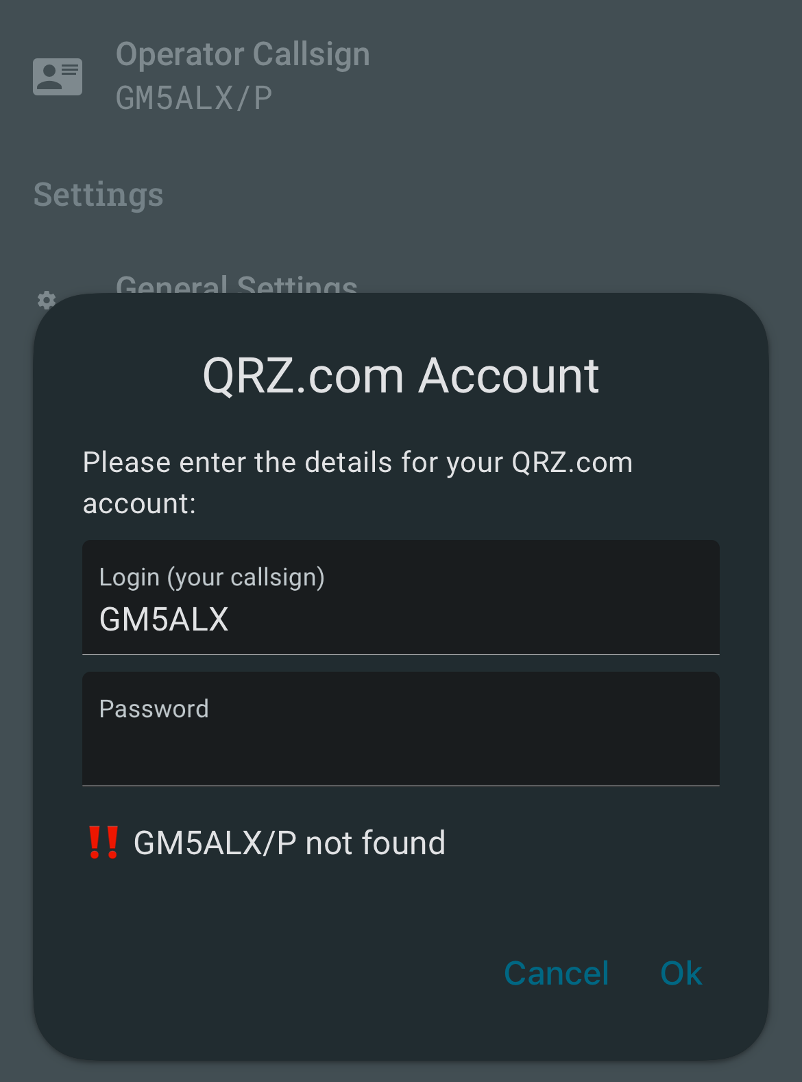

I noticed on my last activation, that the locators weren’t being pulled in from QRZ XML. I checked the login and saw I wasn’t logged into QRZ in the app. However, it won’t log in as it appears to be trying to use my Operator Callsign I’ve set in the settings instead of the user I set in the QRZ login box…hopefully this screenshot explains better:
When I press the check credentials button, it says GM5ALX/P not found, but I’m logging in with GM5ALX, as per the login box.

I can confirm this.
But I can also confirm that if you get passed the credential check with the correct QRZ callsign set in your Operator callsign, then change to /P, QRZ lookups will work.
This is just a work around suggestion.

Yeah, we search your operator callsign as the check.
I’ll fix it to either accept the result of a /P search, or to check using the login callsign.
