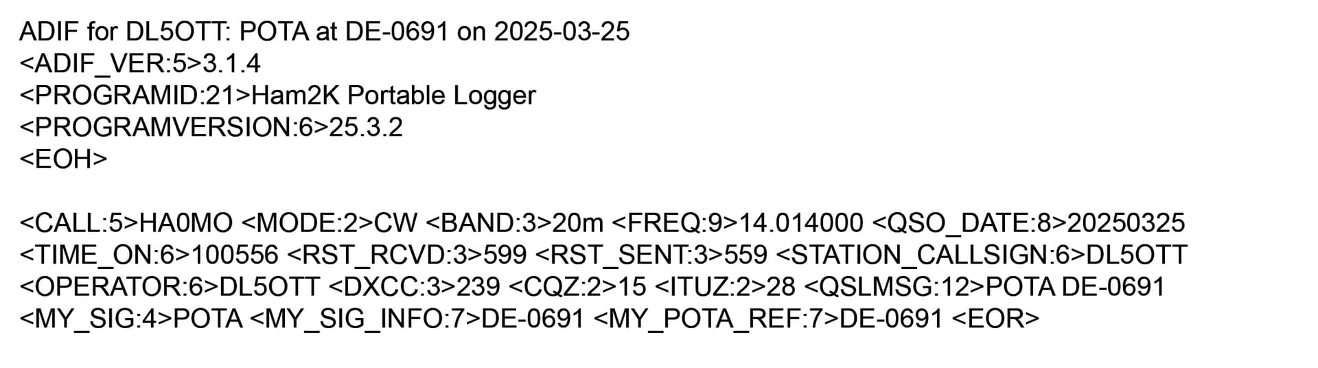

HA0MO CW 20m 14.014000 <QSO_DATE:8>20250325 <TIME_ON:6>100556 <RST_RCVD:3>599 <RST_SENT:3>559 <STATION_CALLSIGN:6>DL5OTT DL5OTT 239 15 28 POTA DE-0691 <MY_SIG:4>POTA <MY_SIG_INFO:7>DE-0691 <MY_POTA_REF:7>DE-0691
This is a line from a POTA-ADIF from PoLo today.
Don’t be surprised, I had to insert a few spaces at some :, otherwise it would have counted as a link here.
Sorry the text is not correct. i take a screenshot. Moment pls
and is this the April pre-release version?
Yes its the actually version
Also, the POTA export ADIF file does not contain gridsquares at all. Only the “full” export file will contain all the personal QTH information.
OK I do not see anything malformed in this image. As I said the POTA export does not contain grids. Only the full file does. Use the full export to import into your preferred logger software. The POTA export is for upload to POTA.app only.
