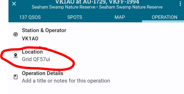

Do you have a gridsquare selected here:

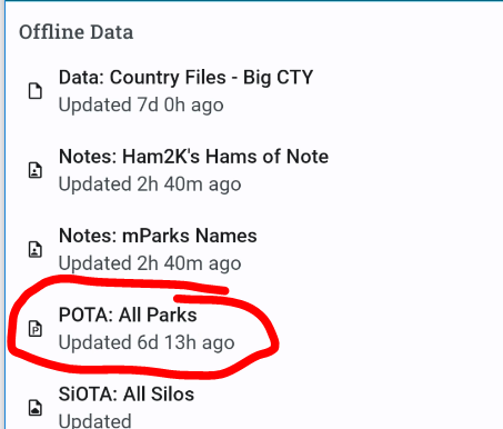

And do you have the latest parks list downloaded in teh Data Settigns?
You may also be so far away from the centroid of the park e.g. a trail or river that no suggestion can be offered.
In this case, you can just start typing the name of the park in question and a shortlist of parks will show below then entry field.
Thank you updating the park list was required
