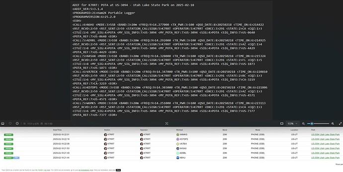

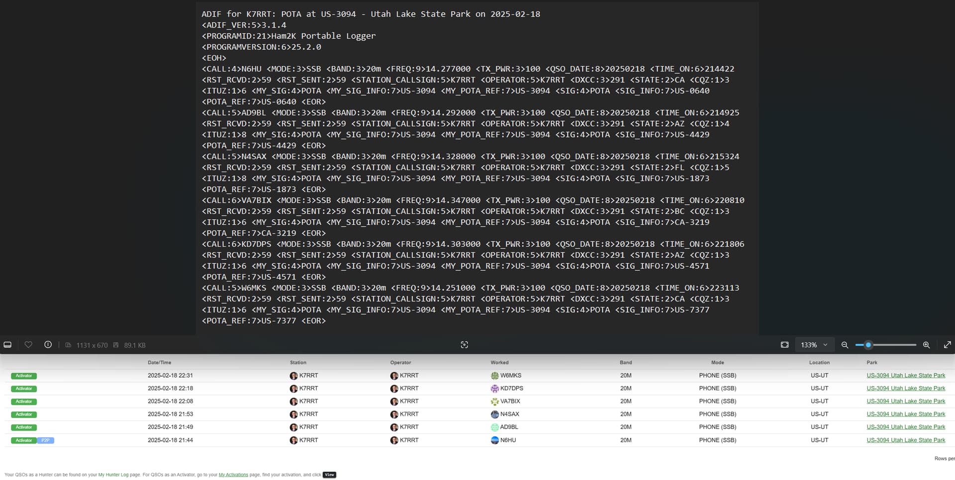

I have uploaded several activations for which I have only made P2P contacts. Of the 10-40 contacts, I’d say 40-50% reflect P2P on the POTA App. I checked the ADIF, and sometimes the POTA P2P info is missing, but today I checked before uploading, and all P2P’s were listed correctly, but out of the 6 contacts, only the 1st reflected a P2P on the POTA App (website). I’m not sure if this is a Ham2K issue, a POTA App issue, or a ME issue. lol TIA
POTA depends on activators uploading. When you upload, the operators behind all your QSOs get their “hunter” credits.
For P2P contacts, you need both operators to upload their logs, and for the data to match.
So what you’re seeing is not a Ham2K issue, or a POTA app issue, or even a “me” (“you”) issue. It’s just a “give it time” issue.
