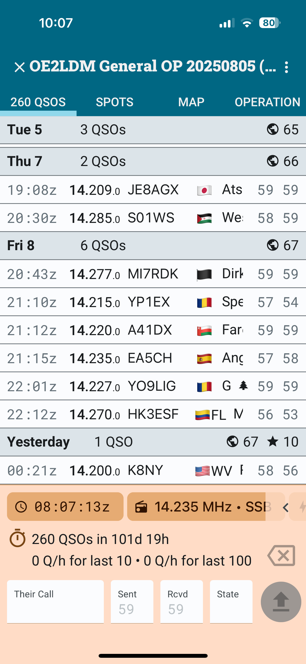

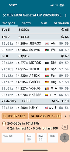

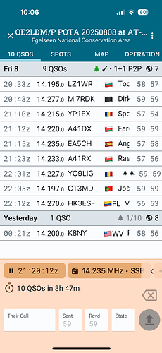

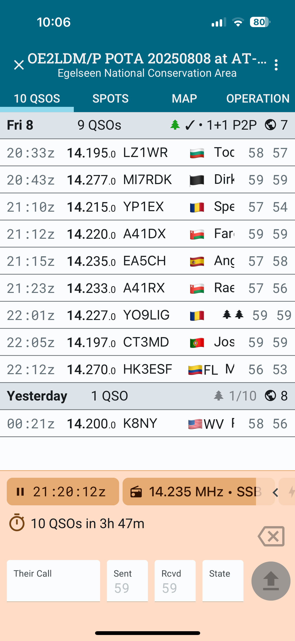

I had this issue several times now. Last POTA activation with a seperate logfile contains 10 QSOs. Import my General Log logfile in PoLo shows only 7 of this 10 QSOs.
I import to QRZ.com also and all QSOs are there. 267 QSOs in QRZ.com - in PoLo I have only 260.

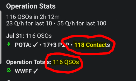

As an example from a recent activation of mine,
I have 116 neat QSOs, which would be exported in the full log and also in the WWFF log as 116 total ADIF lines.
But the POTA log will export 118 contacts because I have 2-fer contacts which add 2 more QSOs into the POTA log.
So there are 118 ADIF lines in the POTA log

I mentioned it. A few individual connections are missing after importing the POTA activity into PoLo. It’s not the case that park-to-park double connections aren’t displayed.
All QSOs imported into QRZ.com (267) are there, but not all of them are in the general log in PoLo (260). I’m currently still using PoLo as my main logging app, but the data management should be reliable without having to constantly check for completeness.
