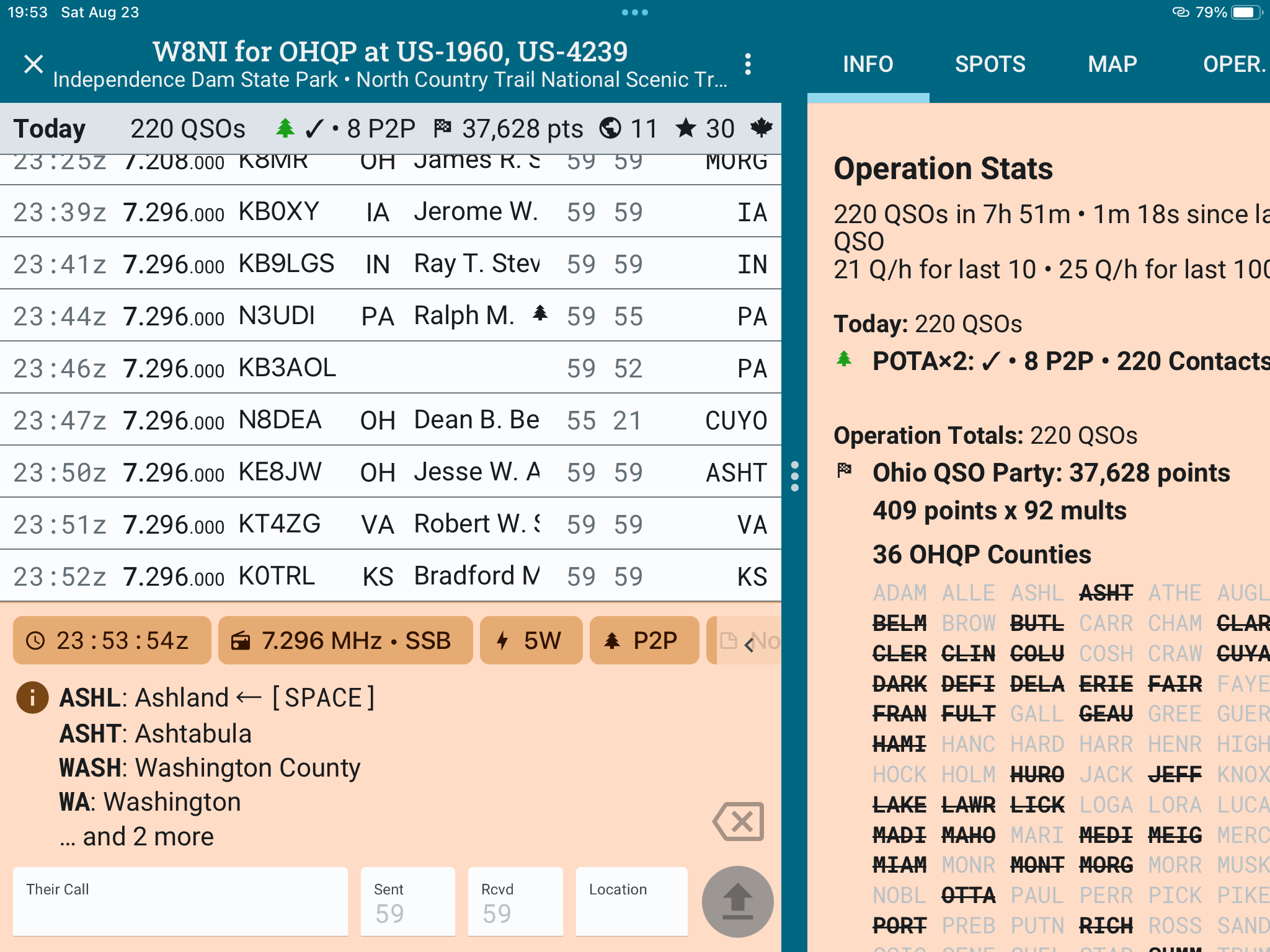

  3. Finally, I know when we enter the location, it provides us a “help" window to make sure we get our multiplier correct. However, after one of the crashes, I had a permanent “help” window showing. I grabbed a screen shot of this and will attach it to this report (hopefully).
