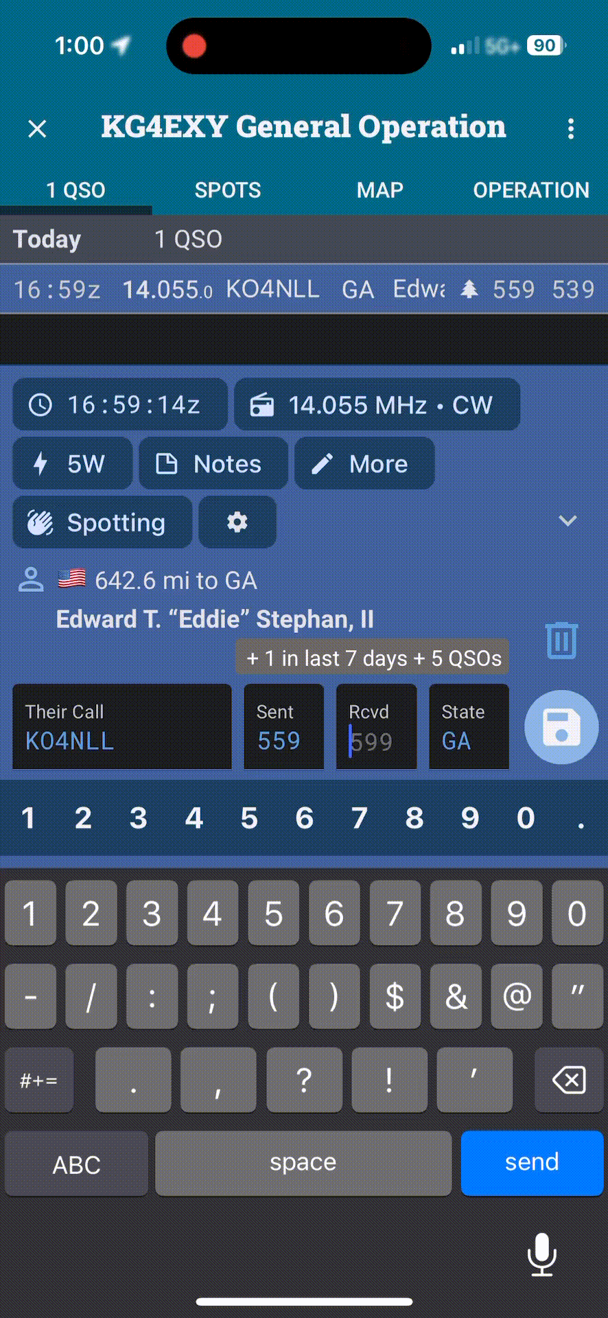

Number bar odd focus behavior in edit fields
Sometimes when using the number bar, the cursor jumps to the beginning of the edit field when typing. This seems to happen more when I’m editing an already saved QSO but I may have seen it on a brand new one. It doesn’t happen with the numbers on the keyboard so for now I just use those.

ScreenRecording
August '25 (patch 1) should resolve this issue. Please test and report.
Thanks, Alan. After testing a bit I still can duplicate one issue with the number bar. If you have something in an edit field, select it and delete, subsequent taps on the number bar will show a single number only in the field. For example, If I have 559 in the Sent field and I select and delete it, tapping 599 on the number bar will show 5 then 9 then 9 instead of 599.
OK thanks
This should be fixed in August’s patch 2, coming this week.
Awesome @KI2D , thank you!
