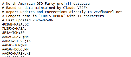

When entering a callsign + spacebar it is pulling the name in from I believe QRZ. It should be pulling the name from VE2FK’s pre-fill database: https://dxlog.net/sw/files/download/database/NAQP_db.txt

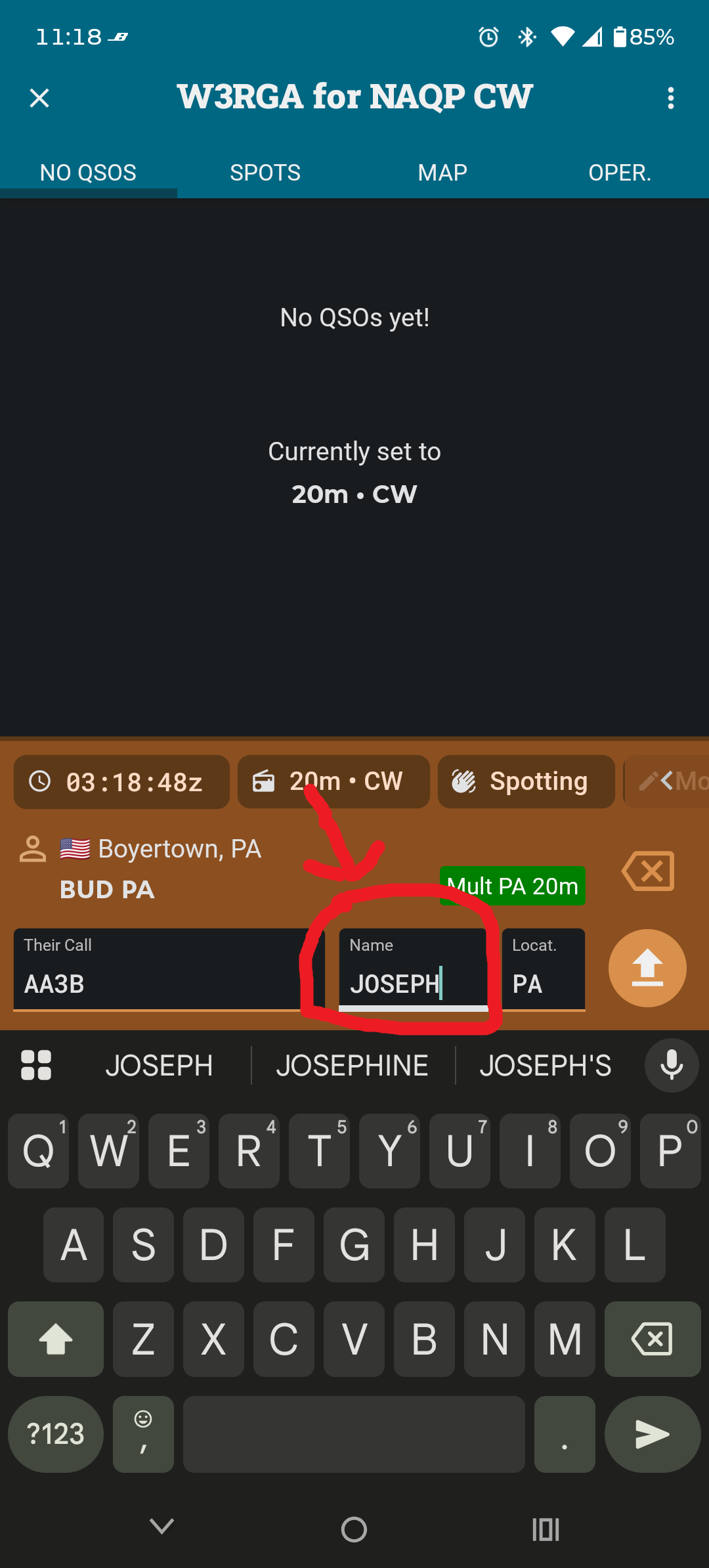

Is there a list of keyboard shortcuts?

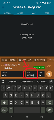

When you tab/space into the name field. Is there a shortcut do delete the populated name?
Are you referring to the fields behind the More button? the fields which are populated from a QRZ or similar lookup?
If so, there are no shortcut actions on this form other than typical long press to select all , copy paste etc
i.e normal operating system shortcuts
long press, then backspace
Jumps it the the state.
Neverminded… My fat finger. HIHI

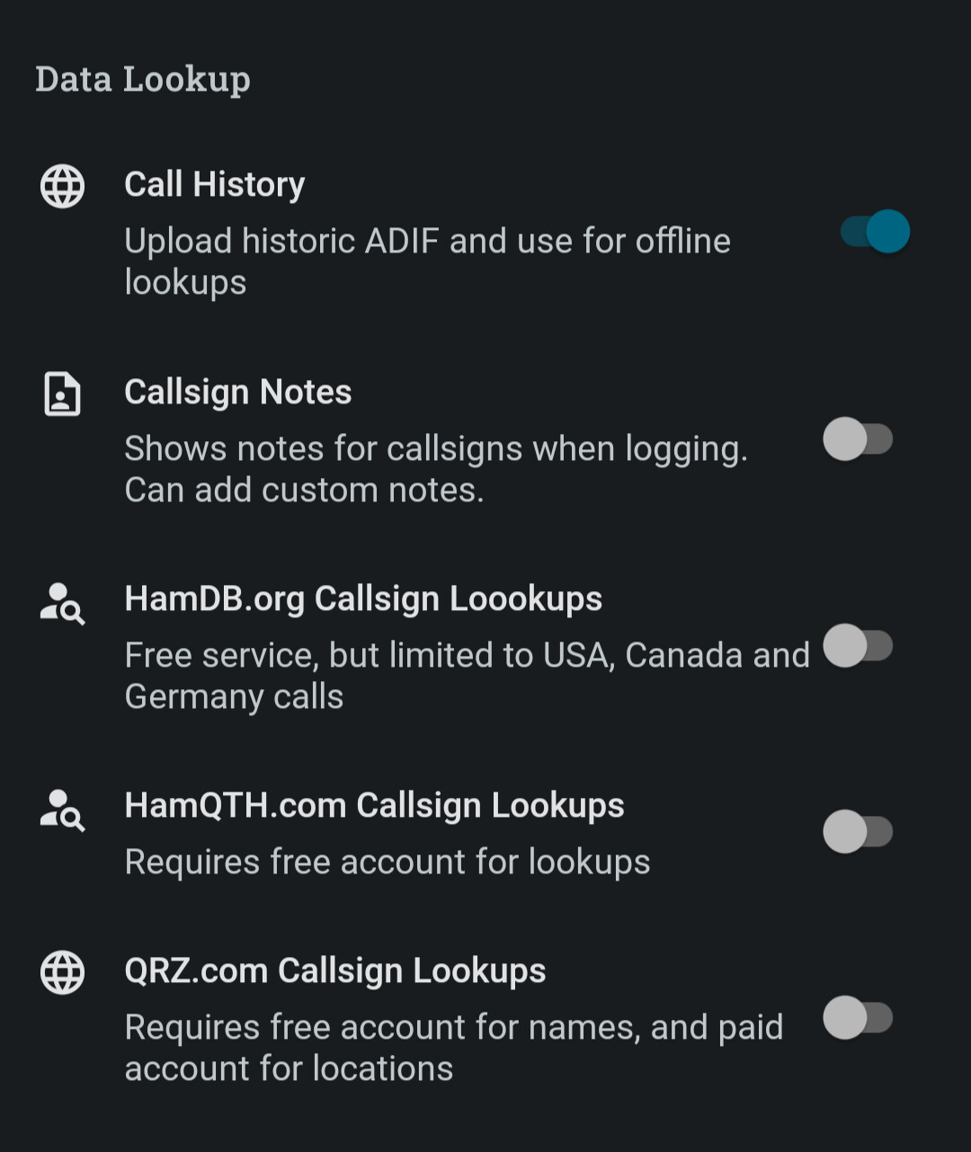

After thinking about this a little more. I created a custom adif using the naqp pre-fill database https://drive.google.com/file/d/1tPgUQW7EMiDBeeKwnpQtuxKr58fDcF-d/view?usp=sharing
Then turned off all “Data Lookup” sources except my custom .adi
Seem to work well. Maybe this will help someone else using PoLo in the NAQP
