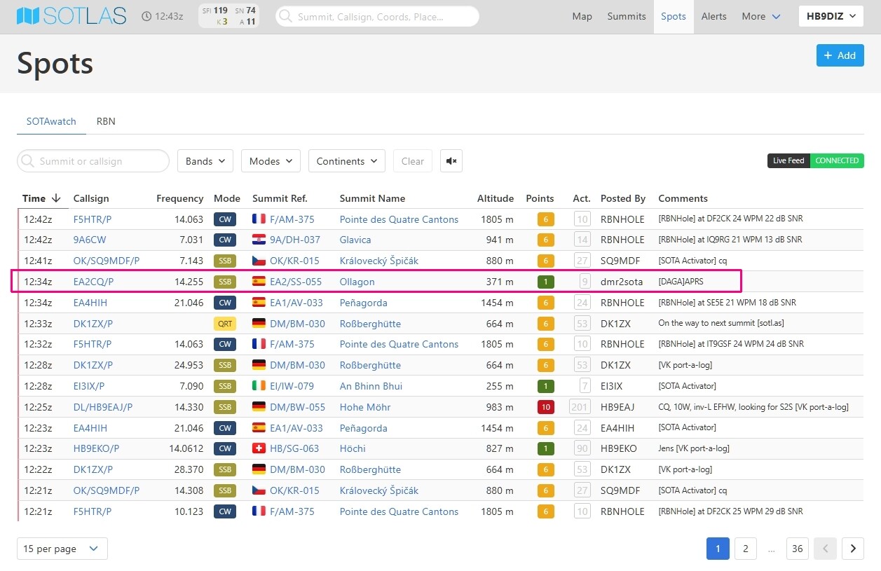

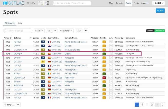

Just noticed here that one particular SOTA spot was not shown on the SPOTS tab within Polo:
a) from SOTLAS

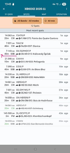

and b) within Polo on the SPOTS tab
Is there a filter or select preventing that EA2CQ/P’s SOTA spot is shown within Polo?

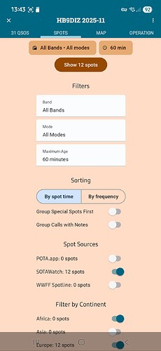

The only filter in place here on my Polo installation is to select only Africa and Europe. Summit EA2/SS-055 is a part of continental Spain in Europe.
And a newer spot from EA2CQ/P came in to SOTA only on 1247z what is after the above picture had been taken at 1243z (time stamp in Polo). And the 1234z spot has obviously not been deleted.
Is there a magic in this . . . ? :wink:

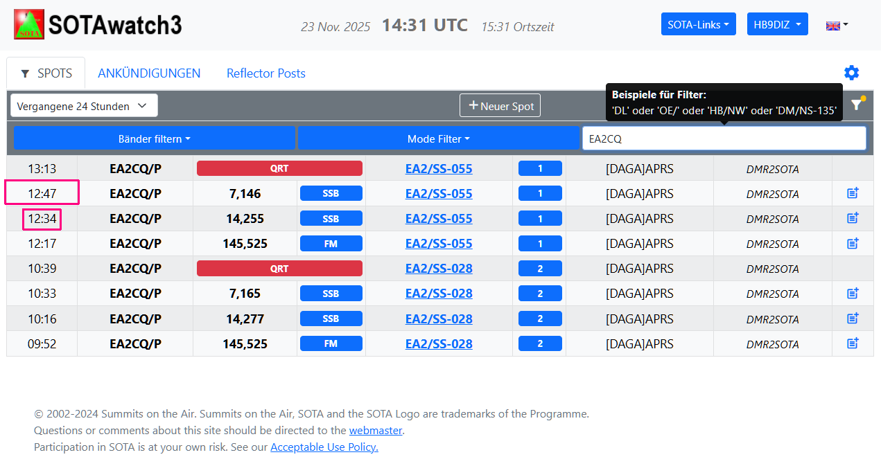

It does seem that this particular spot is the only one in you screenshots that has “DMR2SOTA” as the “source”.
I wonder if the SOTA website handles spots from sources such as that one in a different way, and it is not shared in the APIs we use?

Actually, upon review, I think the reason it’s missing it’s because the spot had been marked as QRT.
PoLo only shows active spots.
Thanks Sebastián, but I am not really convinced of this reason since the QRT spot for this SOTA reference came in only later (1313z, according SOTAwatch3 screen capture) vs. the earlier Polo screen capture taken at 1343 local HB9 time (= 1243z) where this activation still was active.

    "id": 214660,
    "timeStamp": "2025-11-23T12:34:28.087148Z",
    "activatorCallsign": "EA2CQ/P",
    "activatorName": "Iñigo",
    "callsign": "dmr2sota",
    "comments": "[DAGA]APRS",
    "frequency": 14.255,
    "mode": "SSB",
    "summitCode": "EA2/SS-055",
    "summitName": "Ollagon",
    "AltM": 371,
    "AltFt": 1217,
    "points": 1,
    "userID": 34612,
    "type": "",
    "epoch": "df44a4b1-cf88-46ba-b690-ea0ebe1f1103"
Oh, wait.I think see the issue now type should be null, "NORMAL", "QRT" or "TEST". But it’s "", which we aren’t handling. Looks like the handful of dmr2sota spots are all sending that. We’ll look at fixing this.
