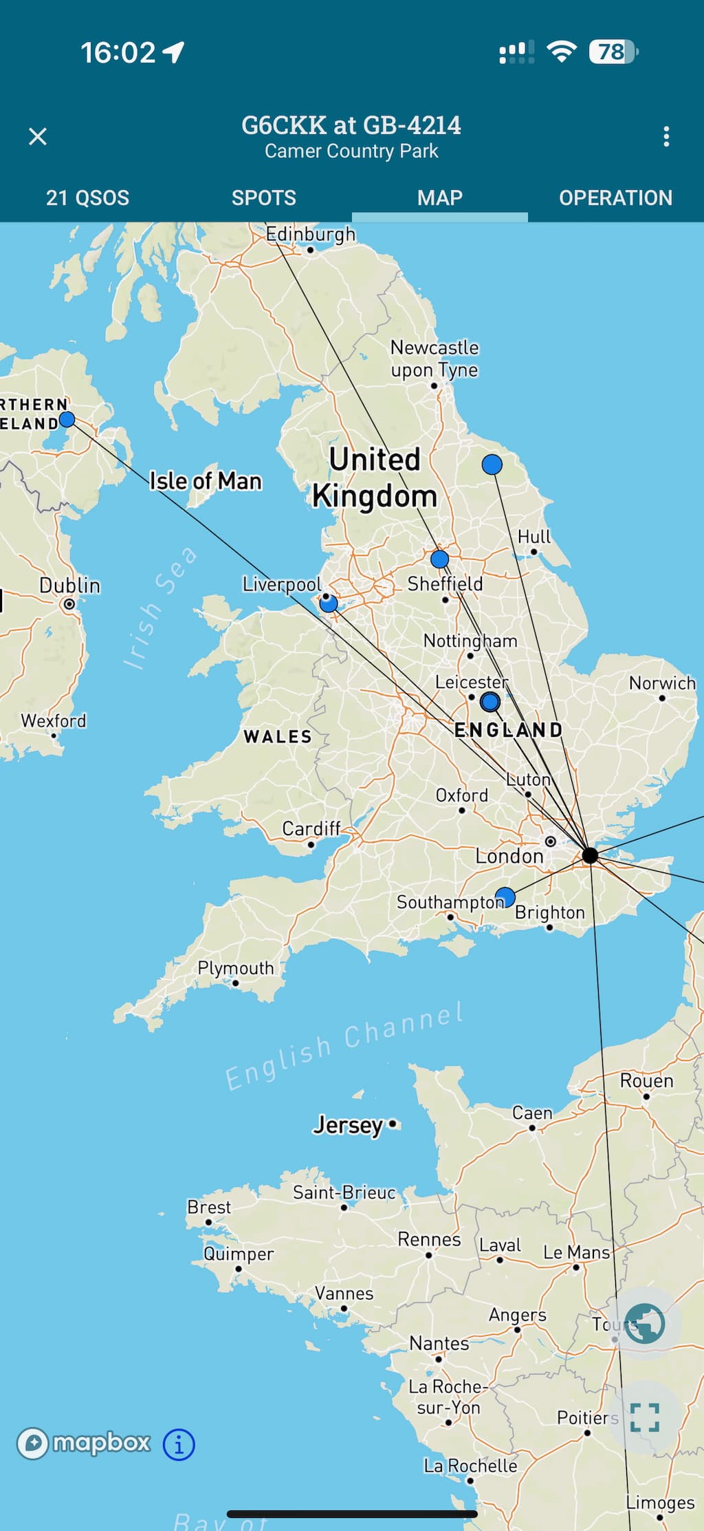

Map not showing all contacts
Is the map supposed to show all the contacts?
I’m on the latest IOS and notice some are missing.
I uploaded the ADI file to another website which pulls the details for QRZ.
I wondered if it’s a bug or I’m missing something?

Bob,
The adi file you have uploaded is the park upload file which is by design the minimum required for upload. i.e. it does not contain gridsquares or other personal data.
The full file does contain personal data which is dependent on your QRZ subscription level. If you have a free account, it will not contain gridsquares.
Any contact in PoLo which does not contain a location will be mapped on the centroid of the country according to the big.cty file.
This may be what you are seeing. More information can be found here:
Thanks for the explainantion and reminding me I should subscribe to QRZ.com
I so just subscribed and now all the map locations are now shown on the map.
Thank you
Bob

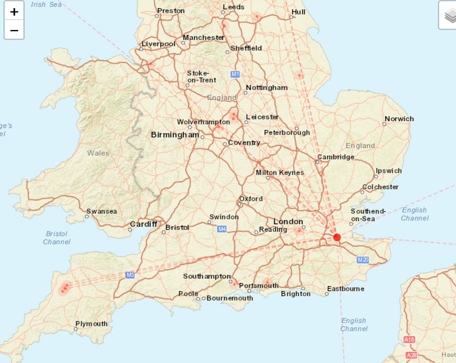

Hi am I experiencing the same thing?
Since this latest update not all QSO’s are showing lines on the Map and it’s not showing other bands such as 17m (and a couple of days ago 10m)
I have a QRZ account but don’t pay for it. Is that the issue? And if so why sone are showing whilst others aren’t?
No QRZ account means you are not getting the other party’s gridsquare. PoLo will be relying on the BIG.CTY file to give you a centroid of the country you are making contact with.
Drill right down on one centroid and you may be able to see that there are multiple contacts on the exact same dot. Makes it look like there are some missing but they are all, in fact, there.

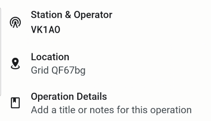

Can you follow these exact steps please:
  1. Create a New Operation
  2. Ignore choosing a Template, ignore adding an activity
  3. Ensure your own location is set - 6 character gridsquare
  4. Leave the band/mode as they are from their last use

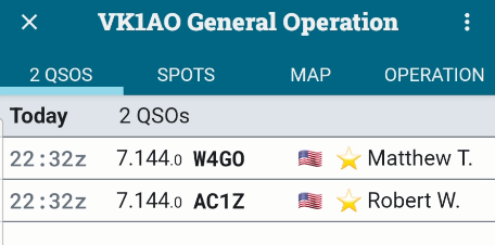

  5. Add W4GO and AC1Z ensuring that each has been looked up with names Matthew and Bob visible

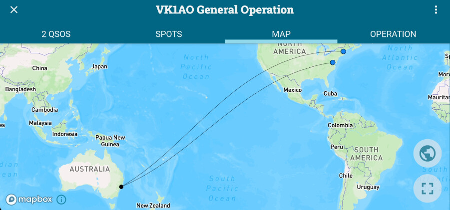

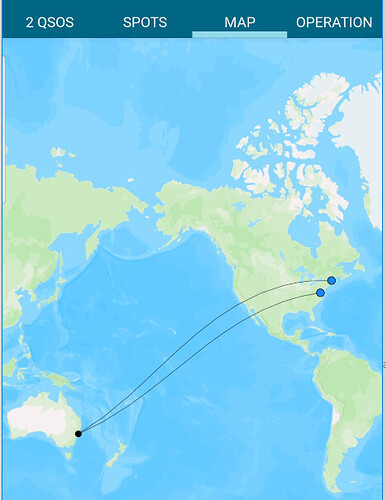

When I follow this simple sequence I get the resulting map below. Depending on the result of these simple steps, we may need to compare your result further.
Thanks again for your support, Alan.
I have followed your instruction, but with the same result: no lines on the map. Only a black point in Switzerland for my side. This point is at the right place.
But the following is different: I can see the names “Matthew” and “Bob” in the entry section, immediately after entering their callsigns, but the log lines in the upper section do not show their names like in your example.

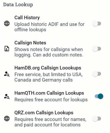

I had disabled the QRZ.com login since I don’t have their subscription. I activated hamQTH.com instead and can see there a QTH code, even in public, for Matthew and Bob. It doesn’t look like Polo would use/take/consider the QTH code from hamQTH.com. Matthew and Bob there show only a 4-digit (large fields) QTH code, what would be better than nothing.

Enable HamDB, which is free, no credentials are required.
Then do a Lookup all QSOs.
This populates the grids for these 2 callsigns
PS, none of the free lookup databases are as reliable as QRZ and QRZ is not perfect either.

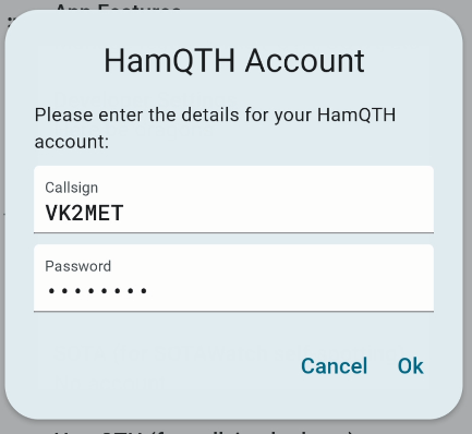

If I create a new Operation with ONLY HamQTH lookups active,
set my location,
then enter and save the 2 callsign W4GO and AC1Z, I get their lookup data set to their two gridsquares
and the map shows both of their dots and lines.
I am assuming you have set your credentials here:
and just to be sure you can test your credentials by filling them in here appropriately and ensuring you have a token returned and not a message saying wrong username or password
https://www.hamqth.com/xml.php?u=username&p=password
