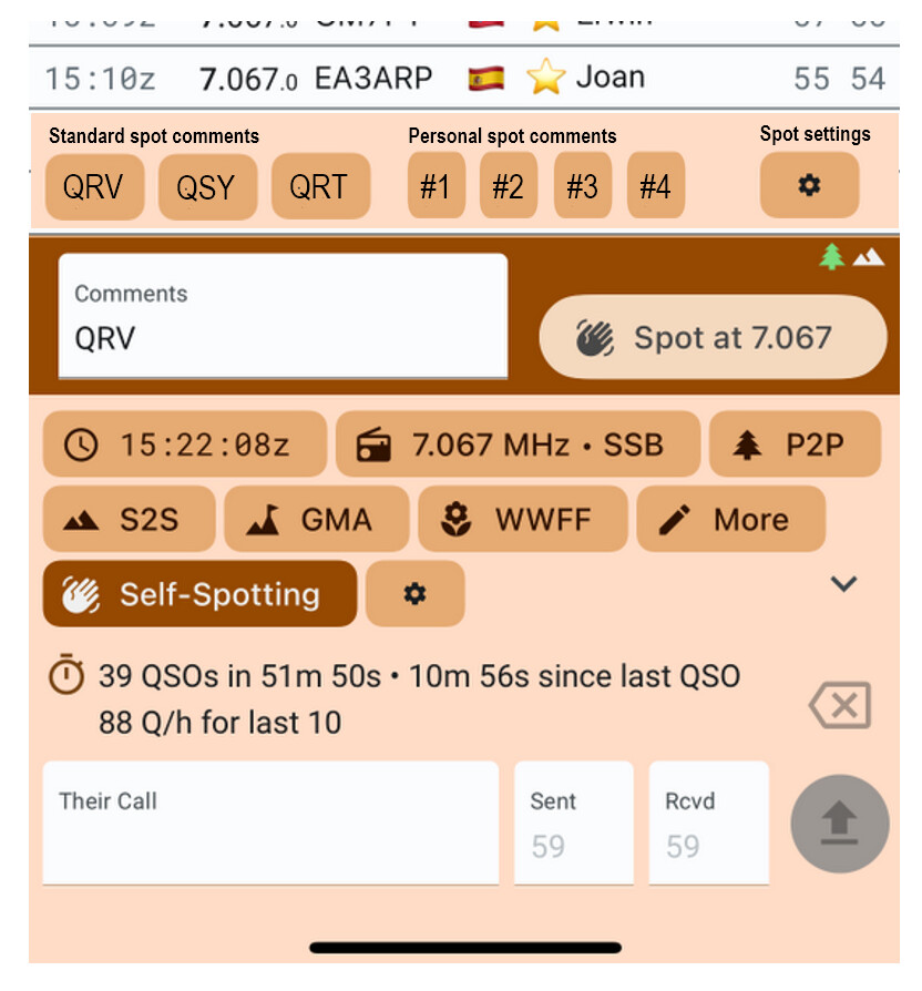

An idea could be to offer selection buttons in an additional line above the existing spotting line seen after tapping the “Self-Spotting” button. A possible solution could look like this:
  • 3 standard spot text buttons: QRV, QSY, QRT;
  • 3 to 4 buttons to select individual (presaved) comments;
  • a button to jump to the settings page or a popup window for the maintenance of these individual comment text conserves.
Hitting one of these buttons would load the underlying text string into the input box. As usual, the next step would be to hit the “Spot at …” button to send it to all activated spotting facilities.
The maintenance elements for the individual comments (“Spot settings”) could be placed on a subpage or a further section of the logger settings. These texts should be saved with the constants of the app so as not to loose them when the phone or tablet is turned off - like other settings of the app - to have them back after restarting the app.
The standard behavior for the next spot should be to offer exactly the last spot again to repeat it. However, each selected text in the input box should be editable to finally add a last word or to delete one as an exception.

I have some ideas on how to expand spotting features, and also “macro” buttons like the ones you propose.
It is, however, a significant UI effort. Not so much the code to put the buttons on the screen, but the part that allows the user to define and configure these buttons.
As we add CAT control and other features, these macro buttons will become more important, so I’ll have to tackle this problem soon.
