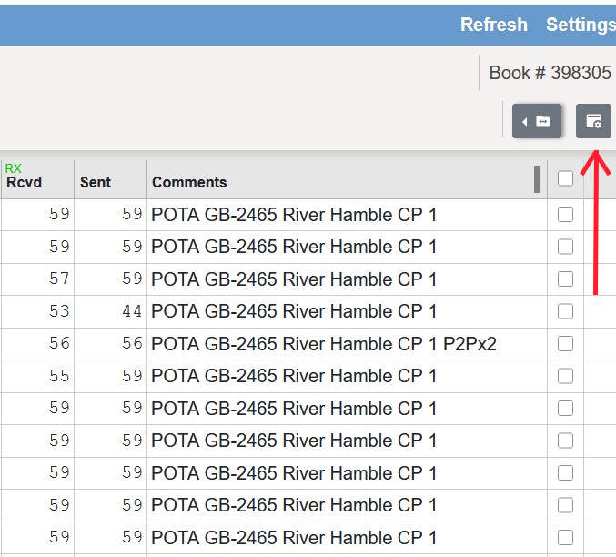

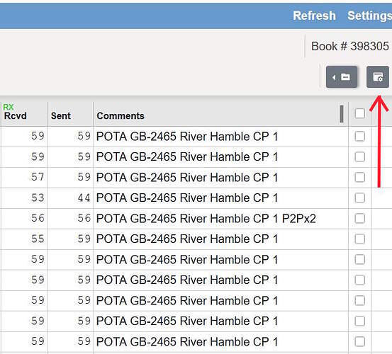

If you activate the comments column in the QRZ logbook, top right, I then use the comments column to describe the QSO. For possible repeat locations or activations I add a separate number at the end for 1st 2nd 3rd activation etc which can be done with Adif Master before uploading.

I could then insert the sequence number using Adif Master and continue to upload. I run adifs through this in any case.
