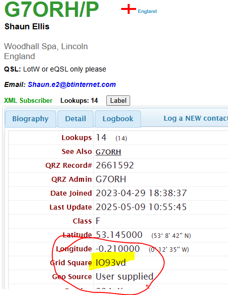

I have a secondary QRZ account for my /P call. The location is set to my home at IO93vd.

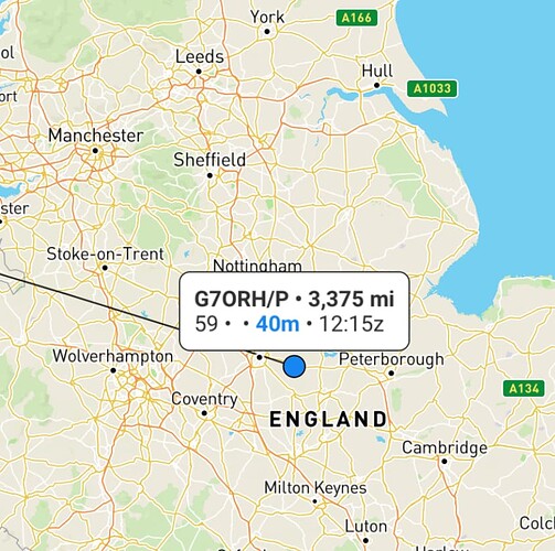

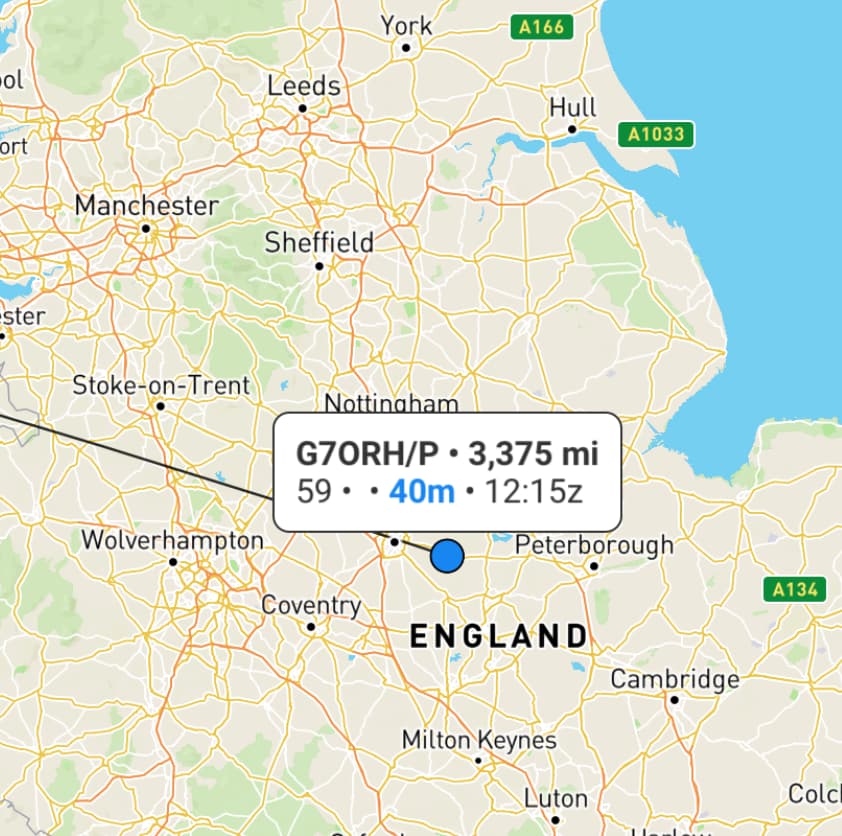

It was pointed out that when mapped on PoLo, my location showed 112 miles away.

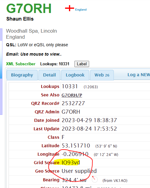

Let’s start with this. When I look you up on QRZ your G7ORH has IO93vd
and when I lookup your G7ORH record it also has IO93vd as the recorded location, Pins are slightly different but grid is identical
When someone pulls this grid from QRZ, the pin for your location on their MAP is calculated by the centroid of the grid. NOT the lat/long of the pin you install on YOUR qrz page.

PoLo uses the grid square from QRZ, not the coordinates.
And if entered with G…/P, it will not use that grid square.
If you enter a park or summit reference, it will use that location.
Otherwise, it will just show the dot on the “center” of England, and it should not calculate distances.
For what it’s worth, this is where the “default” (the “centroid” is the technical term) for England would put you (and any other call) when logged as /P.
