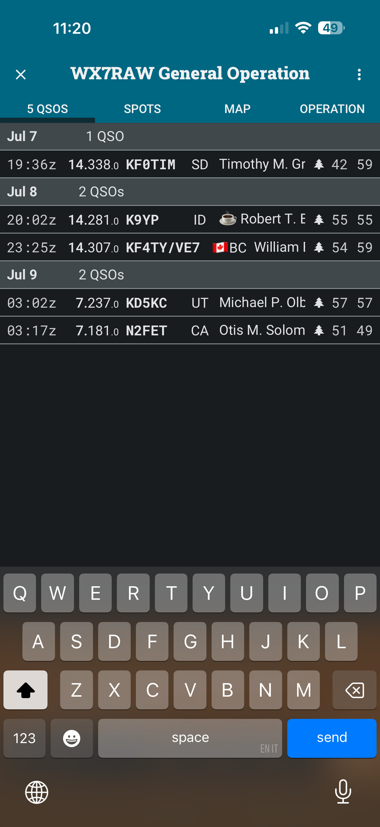

I just installed the iOS 26 public beta today and happened to be playing with PoLo this evening. I noticed that there is a consistent UI bug with the keyboard now that wasn’t there before I updated the OS. When the keyboard opens either within an operation or from the callsign lookup, the keyboard is appearing on top of the PoLo UI (in other words you can’t see what you’re doing). There is a temporary work around by tapping the globe icon.
If it helps I’m running a iPhone 16 Pro Max and did try to reboot the phone to see if that would help (no luck).
It’s possible this is an IOS 26 bug, but I haven’t seen it impact any other apps yet.
It’s also possible that this will need an update in React-Native before this is addressed.

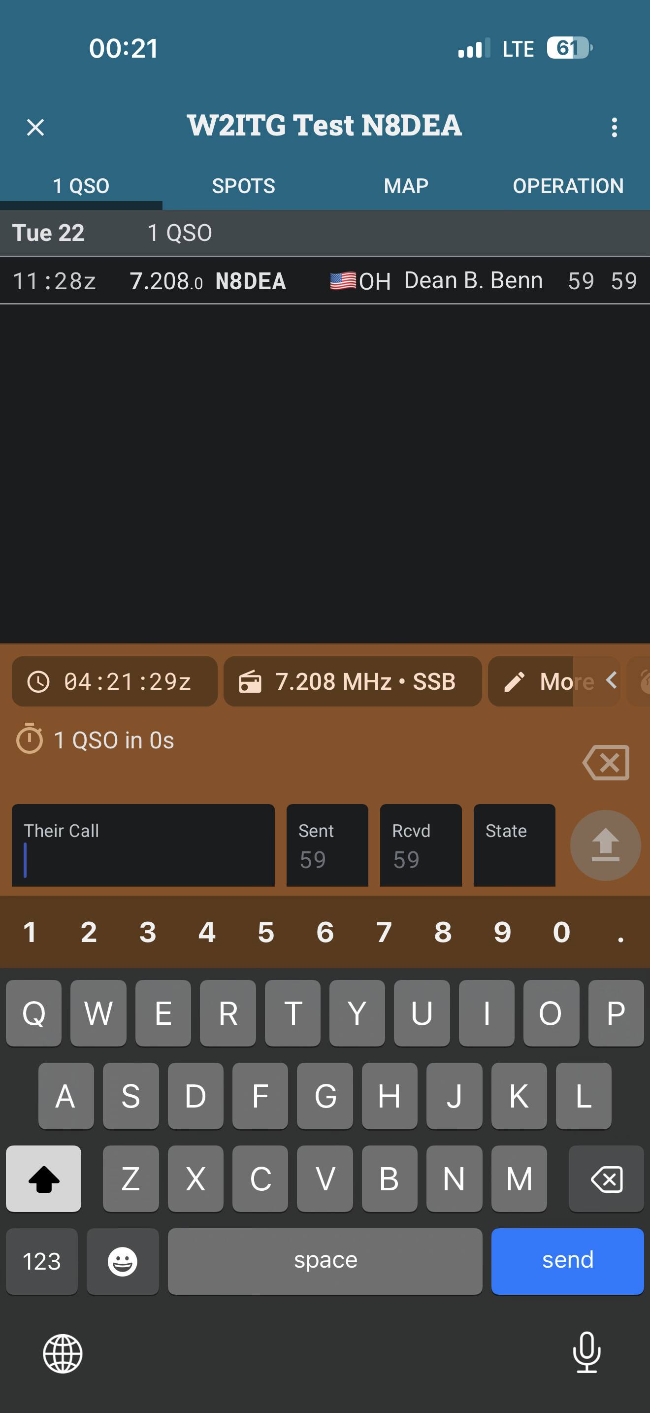

I just did a POTA Activation and the issue was occurring. The workaround does work as a stop gap. Just an extra step to take.
