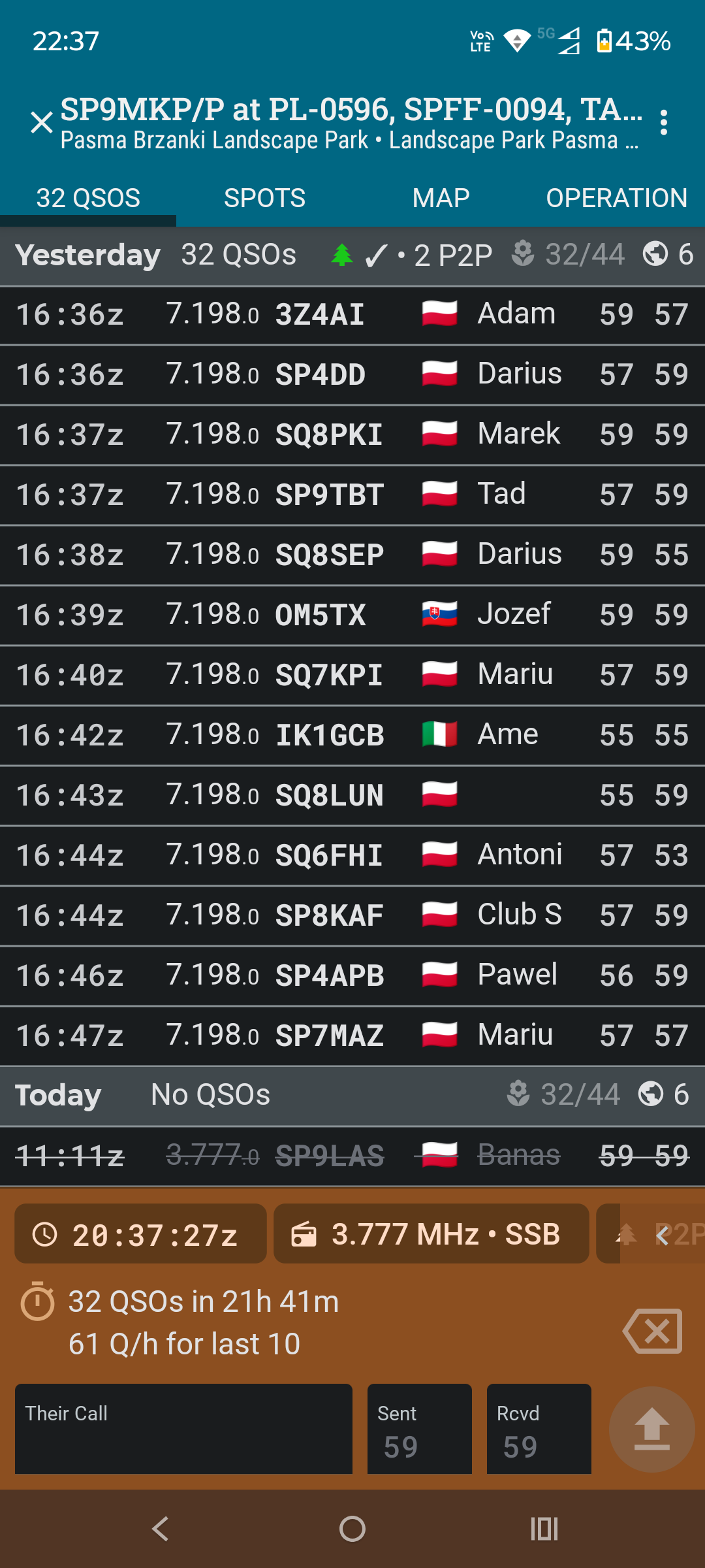

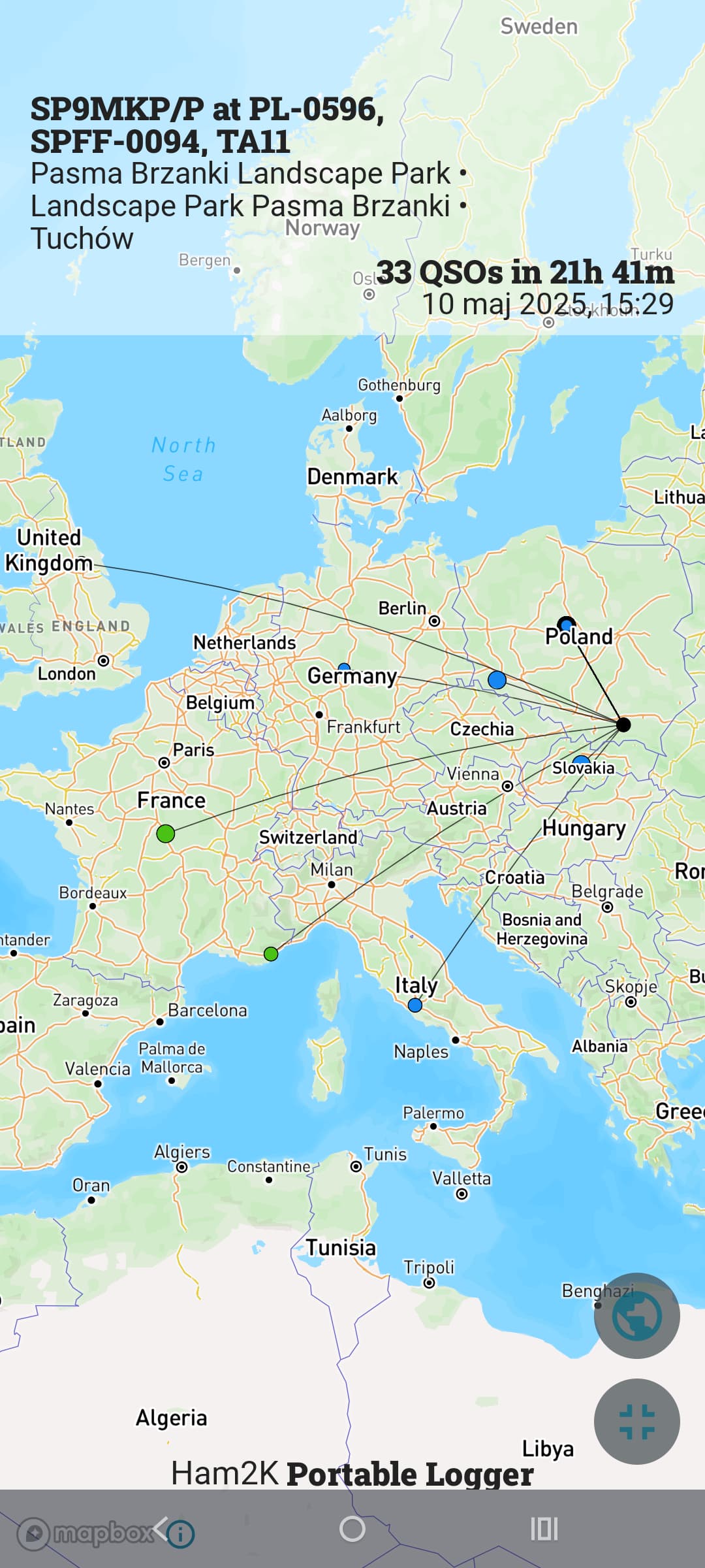

Hi everyone, after the May update a time calculation problem for an activity (map view) still exists on my device. For example if I accidentally add a qso and then remove it, the operation time counts this deleted contact. Maybe there is an option to completely erase a single qso from a log? Matt SP9MKP
