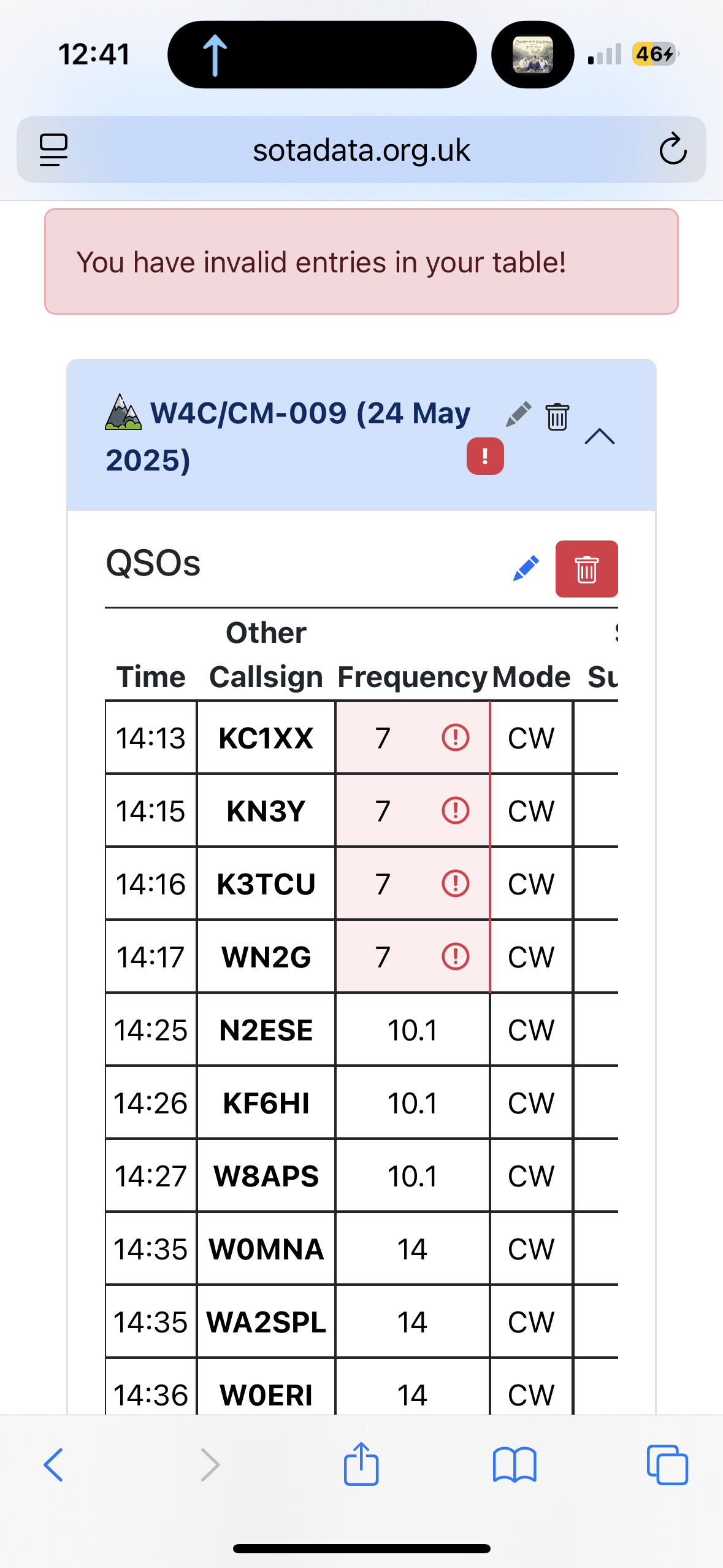

When exporting the ADIF to SOTA, the other bands are being properly recognized without exact frequency entry, but on 40m it is flagging an error on the SOTAData site.
Even after updating the app and deleting/re-uploading the activation there is the issue of SOTA not recognizing the frequency. I then have to manually change the band to 7MHz rather than the mere “7” that is populating.

@KI2D Touching back to this again, still encountering the 40m issue when uploading to the SOTA Database. I’m attaching a screenshot showing the error I’m receiving.
If I enter the actual frequency used on the polo app, it uploads fine but utilizing the default “40m” band selection causes this error.
