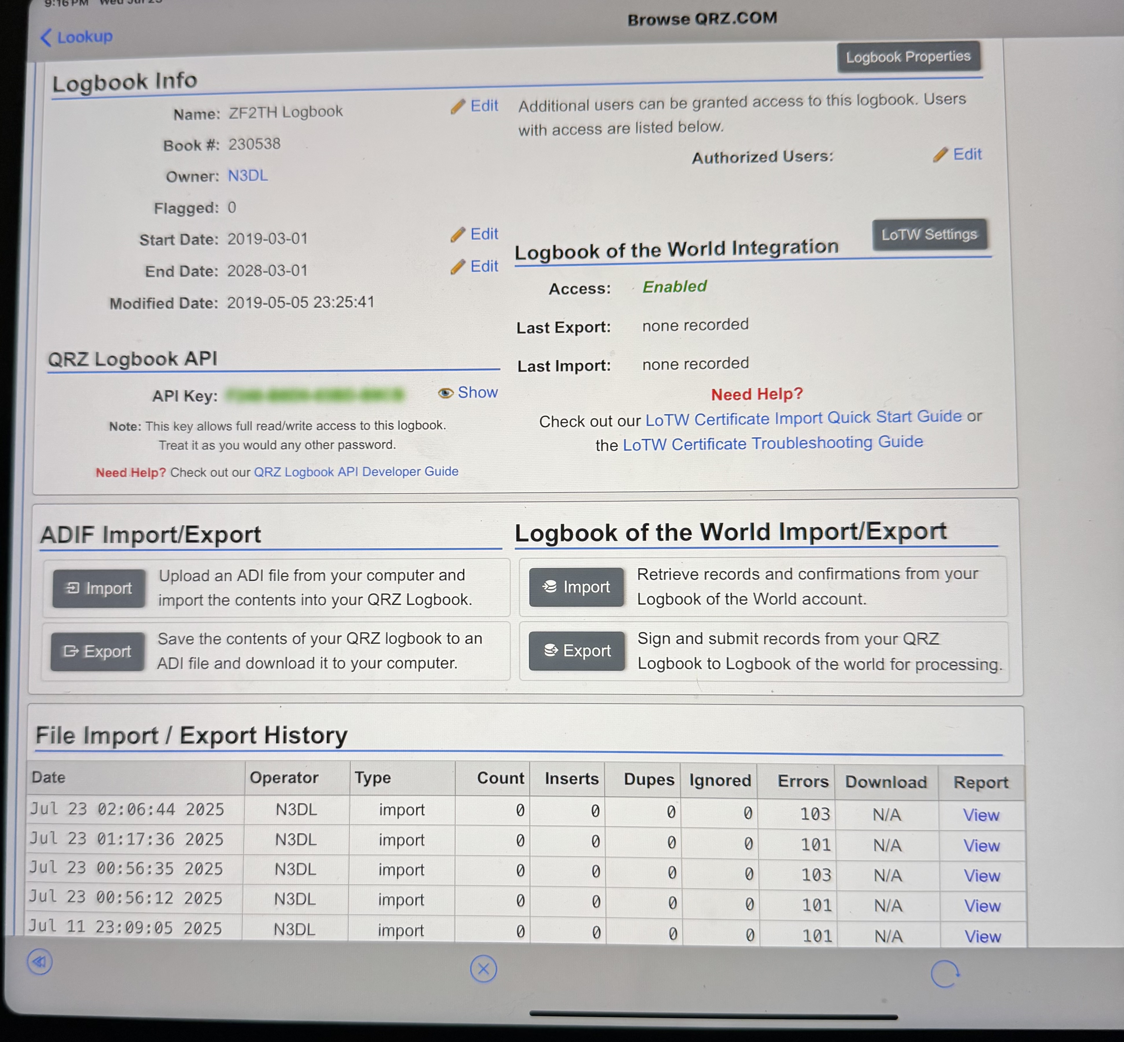

Hi folks I just came back from being in Grand Cayman for a week. While I was there I activated three parks. When I got home I wanted to import my logs to QRZ and for some reason they will not upload. What am I doing wrong? Or is it an issue with the logging software?

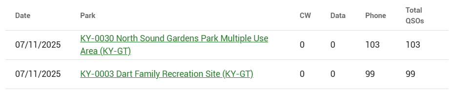

I see these 2 logs uploaded to POTA
Are they the ones in question?

Hi Alan,
Yes those are the two logs in question.

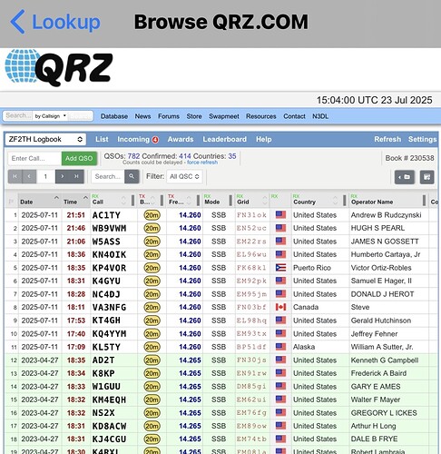

I’m trying to upload them to the ZF2TH call log in QRZ.

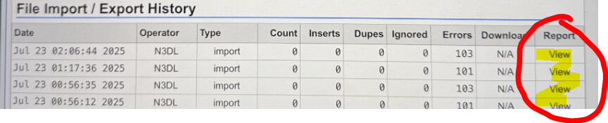

QRZ doesn’t return any kind of notification it just says it may take a few minutes to process.

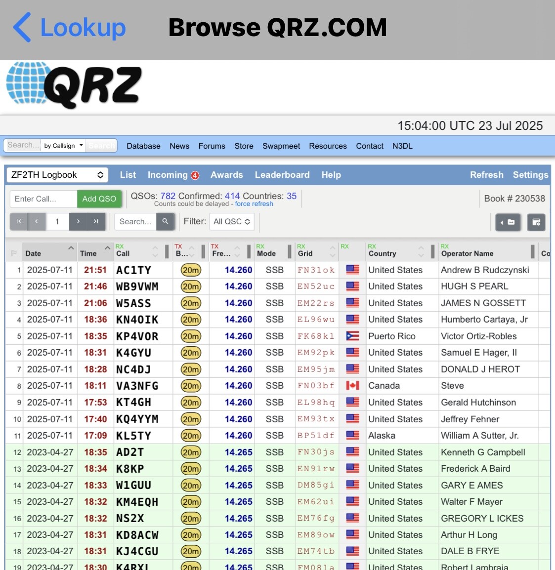

The ones that are showing up are because I put them in manually.

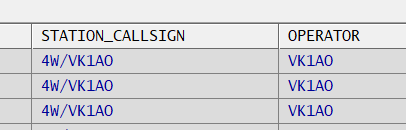

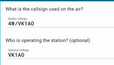

OK so in the ADIF logs - what have you set for OPERATOR and STATION_CALLSIGN?

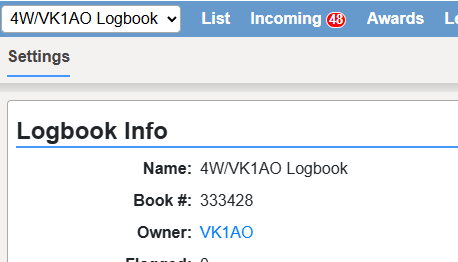

When I go to Timor-Leste, my callsign is 4W/VK1AO.
I set PoLo to Station Callsign 4W/VK1AO and Operator is VK1AO like this:
and the logs are generated like this:
And they upload to QRZ without issue to my 4W/VK1AO logbook:
Does all this correlate with your setup?

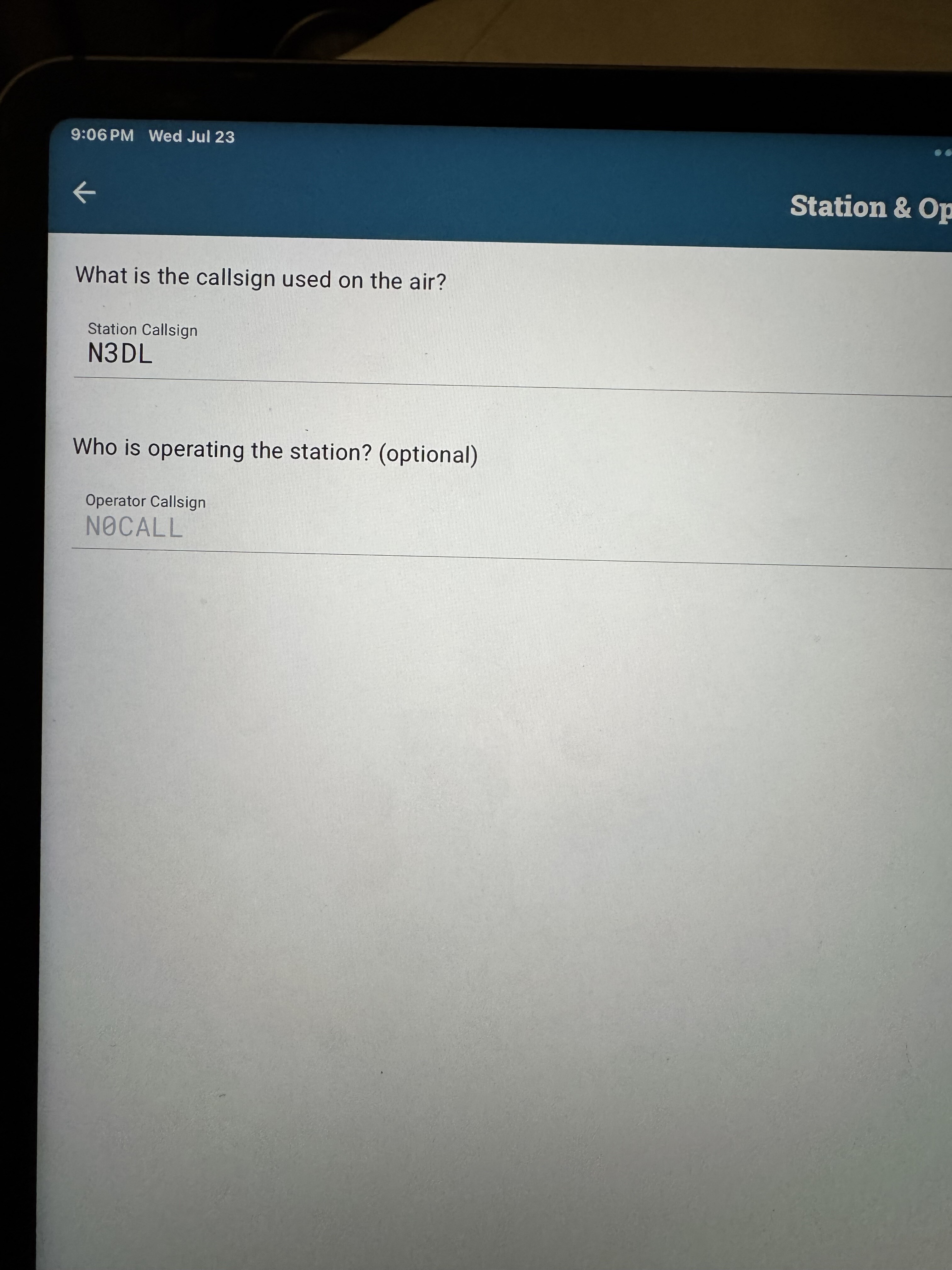

Hi Alan,
Negative. No I didn’t set that up I guess.

Alan,

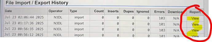

Wanted you to see this page. Errors everywhere.
Tim
Just change the PoLo callsign setup to match what I suggest, then export the logs again.
You should then be able to upload into QRZ into your ZF2TH logbook. The dupes, if any, will be ignored.
Did you view the report to confirm the issue?
No I didn’t but I will.

Thank you so very much Alan that was the problem. Put in the ZF2 and they all uploaded just fine. Lesson learned I must say!
