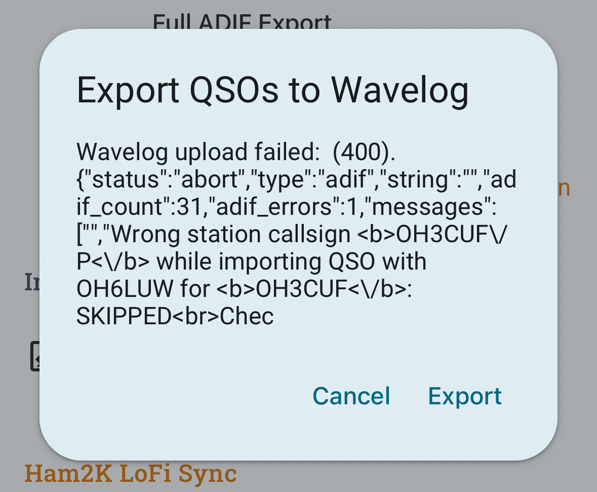

When trying to export activation log to Wavelog (which I have done with /P suffix) it says “Wrong station callsign” as result from Wavelog.
I created /P station to Wavelog and linked it correctly.
I got quite the same errors in Wavelog when I tried to import ADIF that has /P suffix. Then I went to the “stations” and set the /P station to active and it imported fine.
Dunno why Wavelog thinks suffixes are not the same “station”.
