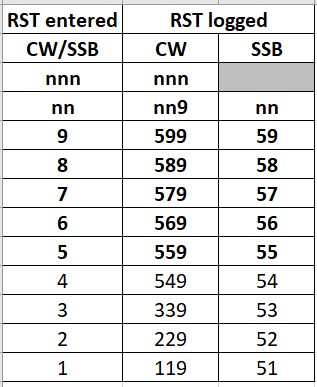

I would like to wake up this request from sleep mode and make a new proposal:
Most important in real life are the top rows (S5…S9).
73, Markus HB9BRJ

I’ve added this on the latest “March pre 2” release.
And because life wouldn’t be fun if we always do what we say we’d do, I changed it a bit.
Right now, it will do 1 → 31, 2 → 32, 3 → 33, 4 → 44, 5 → 55, 6 → 56, etc.
Hopefully this should be acceptable to HB9BRJ but also VK1AO, and myself.
