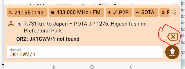

When you tap a spot to prefill all details (similar to vk-port-a-log), or just fill in details in preparation for saving the QSO, you may revert all fields to blank and return to your calling frequency by tapping the back button here:
Is that what you mean?
:joy: — yesss!
I must admit that I had in mind that this backspace key triggers something else, so I’ve even not tried it. Sorry, haha.
Thanks, Alan, and vy 73
