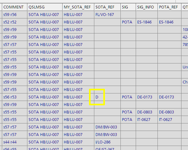

It was a bit nasty today where I had entered their park reference in the SOTA summit box in the bright sunshine erroneously and could not delete it later to blank. Had to correct all ADIFs manually to cope.
