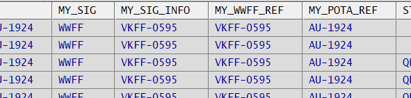

With a dual activation. What determines the value of the MY_SIG field when activating WWFF and POTA?
My Full Logs have MY_SIG = WWFF
Is there a way of making the MY_SIG/MY_SIG_INFO fields POTA?
Or is this because POTA will accept MY_POTA_REF and ignore MY_SIG.
If I work a Silo and a WWFF and POTA park. which activity gets the SIG_INFO in the ALL Log?

OK just tested swapping them and the full log reflects the order.
So just adding the extra bit to the title is all that’s needed.
@KI2D It’s actually a little more interesting that this.
Multi activation… First in the list comes first EXCEPT when you do a Park2Park and do not record the park number of that first program.
So e.g. POTA then WWFF.
Select spot for Park2Park which contains only the WWFF reference.
Export is then SIG=POTA, but for QSOs with P2P WWFF and no POTA equivalent installed, SIG becomes WWFF and POTA is ignored.
