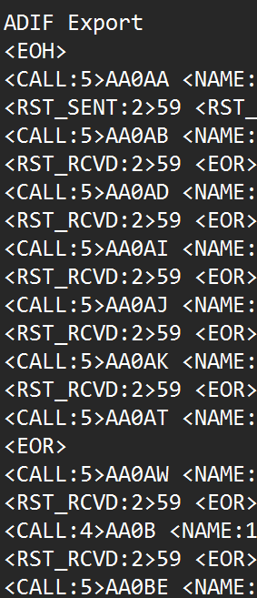

As an update, I was able to get some code written that takes the entirety of the US database (EN.dat) and puts rows of info with Callsign, Name, Address, City, State, Zip.
It then takes that data and creates a dummy adif file.
It sets the QSO time to January 01, 2001 at 0700 hours on 160M with 59 signal both ways.
Going to try it with a much smaller file size (100 lines or so) and see how the program handles it.

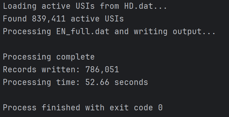

Alrighty, was able to get my python code running.
It looks in the HD.dat file to determine what call signs are active and what are not. It then searches EN.dat for ONLY those active call signs and makes a dummy .adif file.
Total file size right now is 149mb and it takes about 52 seconds to process the database.
