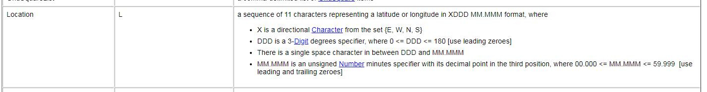

Adif includes this as a field under <‘LAT:X’> or <‘LON:Y’> without quotes.

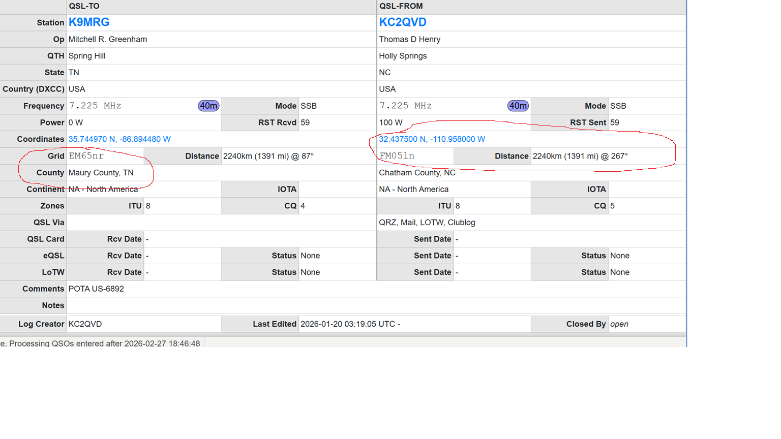

I then did a POTA and uploaded the full export which does include the Grid, County, all that fun stuff. Went to go look at a confirmed QSO and noticed “ah perfect, it does pull the info from the adif! And as I was about to click out, I noticed the distance between the two stations (TN and NC) could not possible have been almost 2k miles. Clicked on the Lat / Long values which took me to google maps and plopped me right into….AZ…. Because for SOME reason, even though I provided the Grid info, QRZ does not automatically update the Lat / Long which effects distance to other station. HOWEVER, oddly enough, if I went to edit the QSO and just simply “clicked” in the grid field, this updated to the correct coordinates. I didn’t type a new grid, didn’t edit anything, I just clicked the field. Really odd… Anyway, it was then that I realized the contest and POTA adif files I uploaded pulled the wrong info (since my logbook settings were still set up for AZ), and needed to correct it.

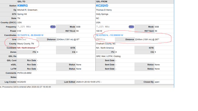

Highlighted below from my QRZ post. All grid and state and county info is correct, but coordinates and distance field are incorrect (No part of NC is 1400 miles from any part of TN). This is because my logbook settings still reflected AZ. Unless I update my logbook settings each time I go out into the field, this will always be slightly off as it will default the distance and coordinates to my home. The only way to fix this is either;
  1. Update my logbook settings everytime I want to go out (which I really do not want to do, I probably wouldn’t even do it for NC based activations).
  2. Include the LAT / LON info in the adif file so that it gets loaded for the contact.
I still don’t know if including those fields would update them in QRZ, I have to test them.

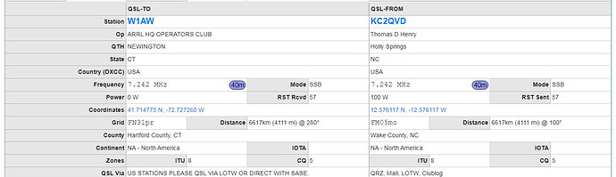

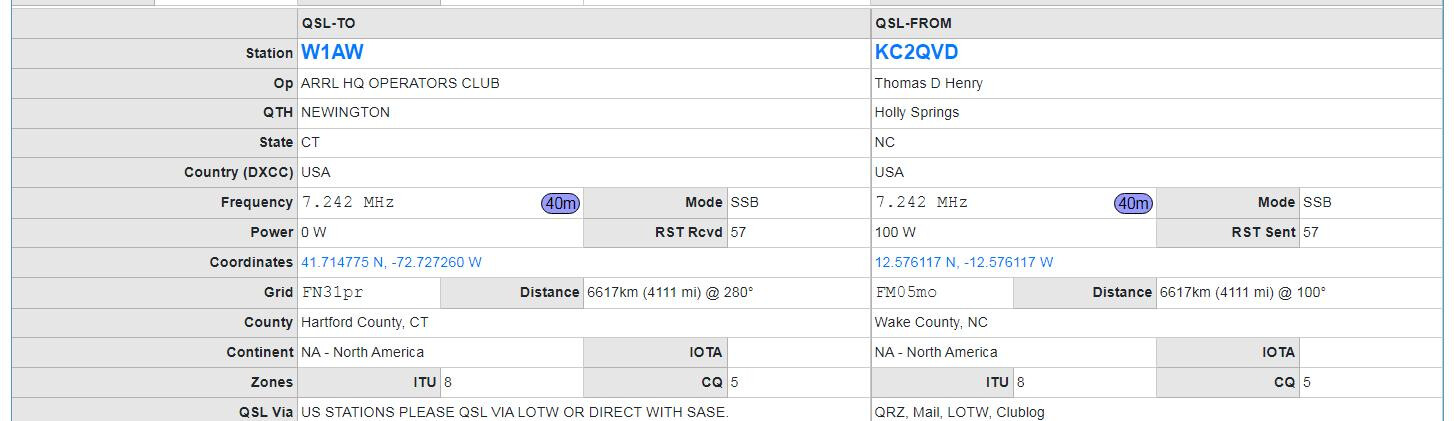

FYI, I tested it and it was able to work correctly. Huzzah.
Created a dummy contact and updated MY_LAT and MY_LONG
Using the adif formatting for this field.
And this yields that info translating into QRZ (under my info on the right).
OK but you will still be totally at the mercy of what their QRZ record says for them, as far as accuracy is concerned. You may think that the distance is correct… but they may well NOT be where QRZ says they are. And the distance will be totally wrong and you won’t perhaps know it or be able to fix it.
