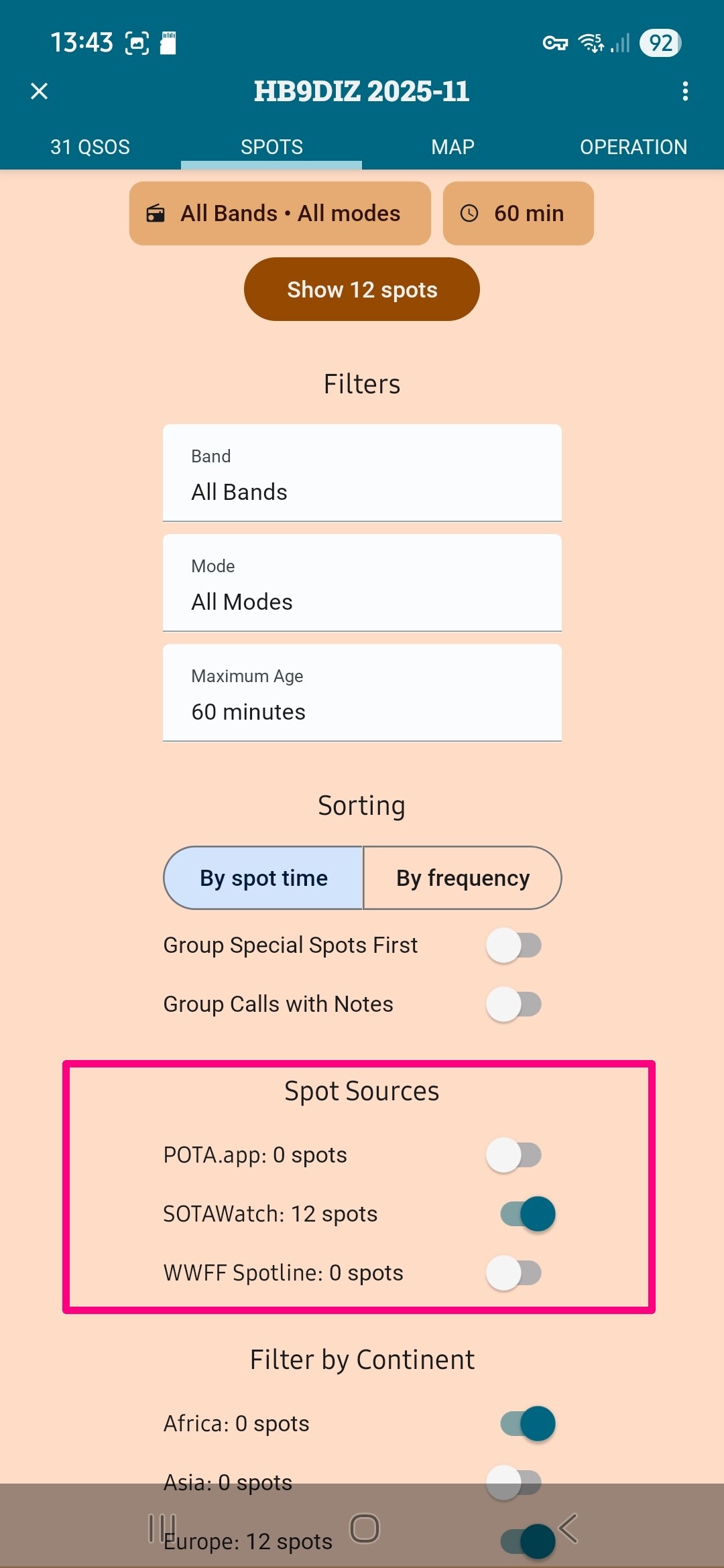

GMA is turned on as a location-based activity in the “App Features” section of the Settings in my Polo installations on Android and iOS, but this doesn’t turn on a forth possibility “GMA” in the “Spot Sources” section of the settings page of the SPOTS tab. This is what I had understood from above. I don’t see spots for GMA references in Polo or a switch to turn on/off such, despite their homepage cqgma.org shows such spots on their QRV/cluster page. Or do I have misunderstood something?
I would appreciate to see spots for GMA references on the SPOTS tab – this to use the comfy side of Polo and to tap such a spot line to copy its data incl. all given references to the QSO logging line like for SOTA, POTA or WWFF! :slight_smile:
