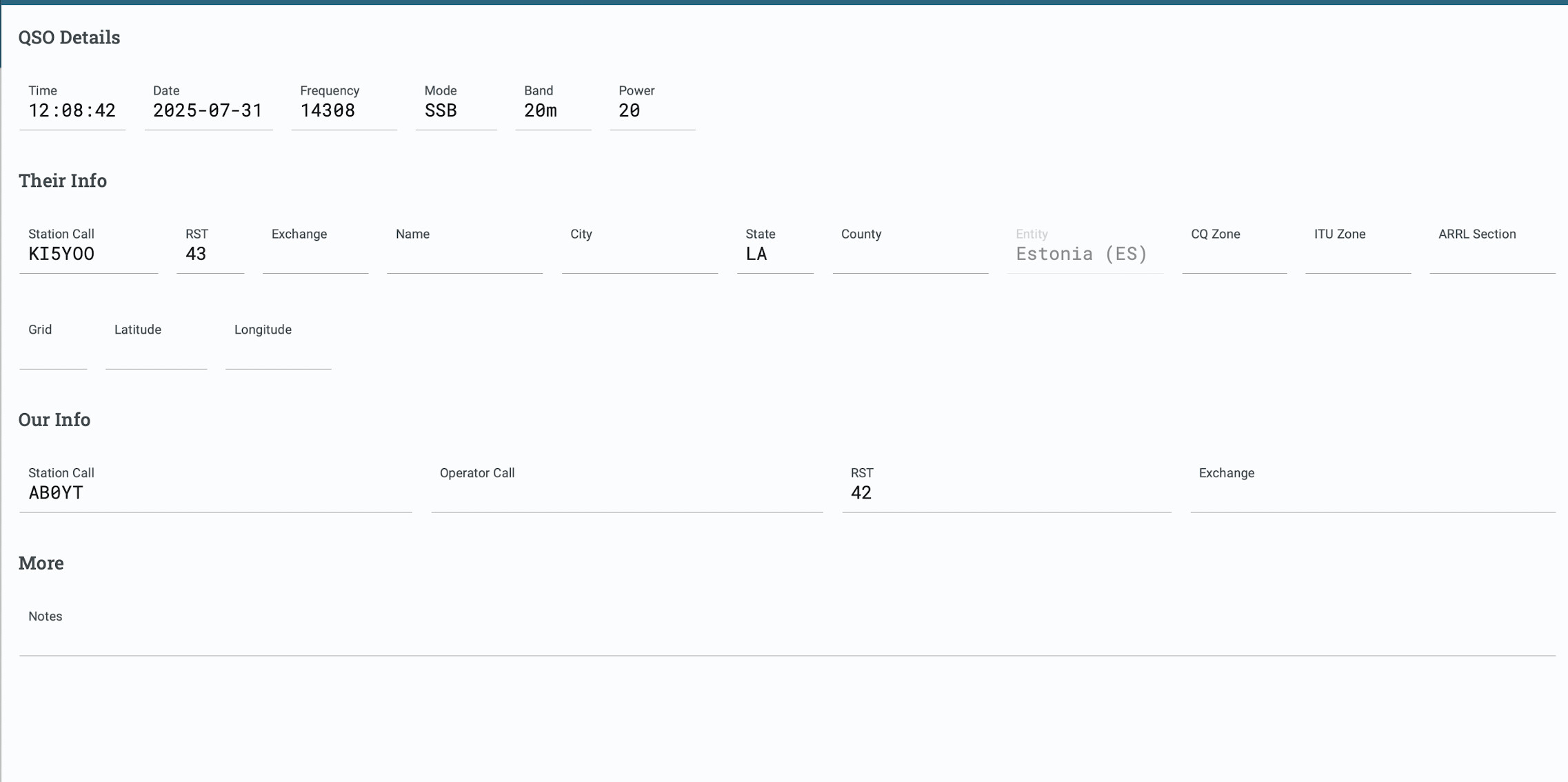

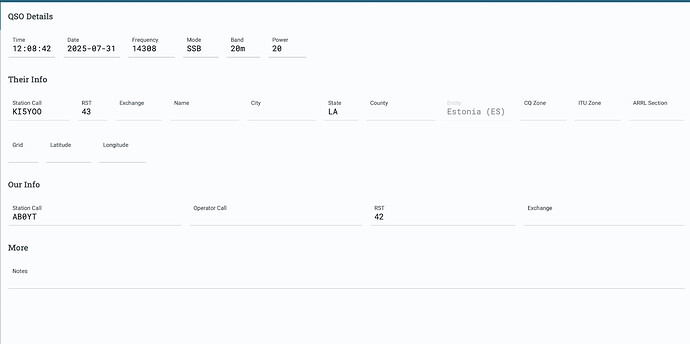

I’m a new PoLo user and loving it. However, I am seeing an odd issue with one of my QSOs this morning. I had a contact with KI5YOO, and recorded POTA Park US-2369. Despite both callsign and park # being US, PoLo recorded the QSO as being with Estonia. Even though I had WWFF unchecked in the QSO details, it had apparently been prefilled with an Estonian WWFF entity. Even after I cleared that entity, PoLo still has the entity locked to Estonia.

I’m pretty close to the default configuration. I have QRZ toggled on but haven’t logged in yet. HamDB is also toggled on.
Will follow up on your other question when I export the log.

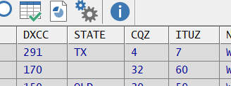

From the QSO in question:
DXCC: 291
State: LA
CQZ: 4
ITUZ: 7
Also, while logging into my free QRZ account did nothing relevant to this issue, when I logged into HamQTH it correctly re-coded the QSO as USA. While the DXCC field in the dialog may not be exported, it does appear to correspond to the flag displayed on the list of QSOs for the operation, as well as the map view.
