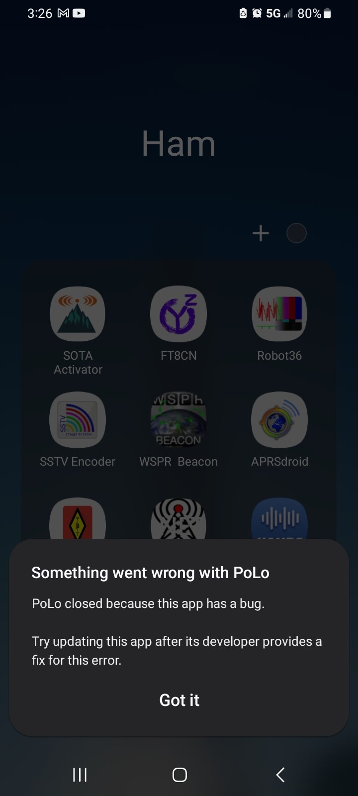

Even after clearing the cache and reinstalling, my device claims the app has a bug and refuses to start

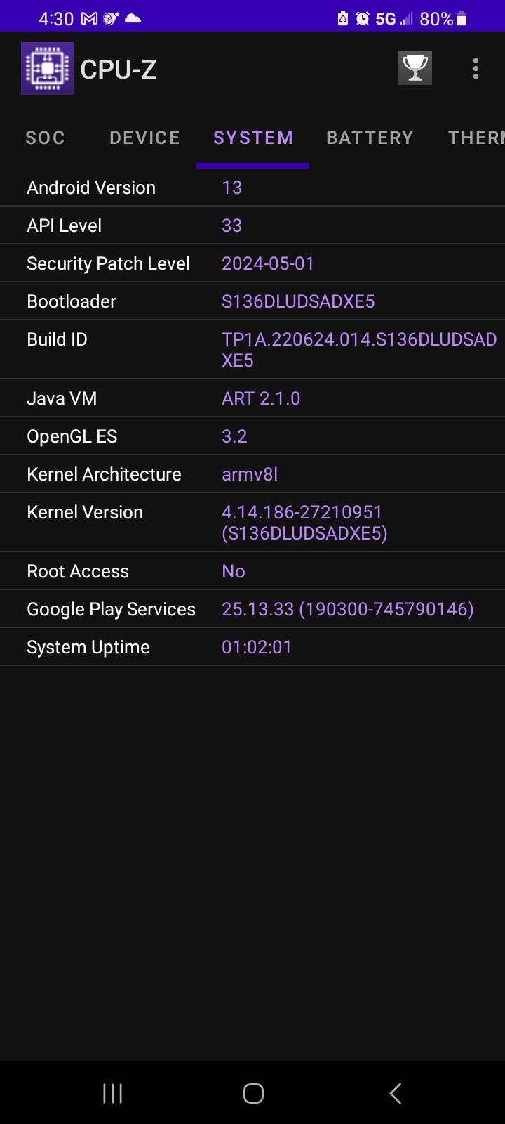

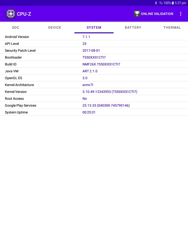

Can you install this app:
and look in the “system” tab for information about “OpenGL ES”?
We need to see if the version of OpenGL ES less than 3.2

Do you know what version of Android are you running?
Android version 13

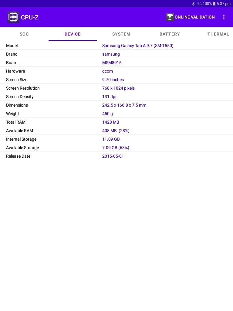

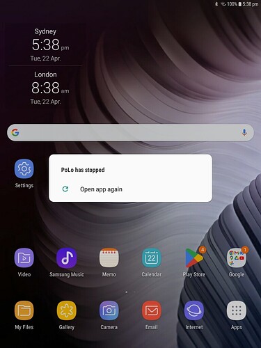

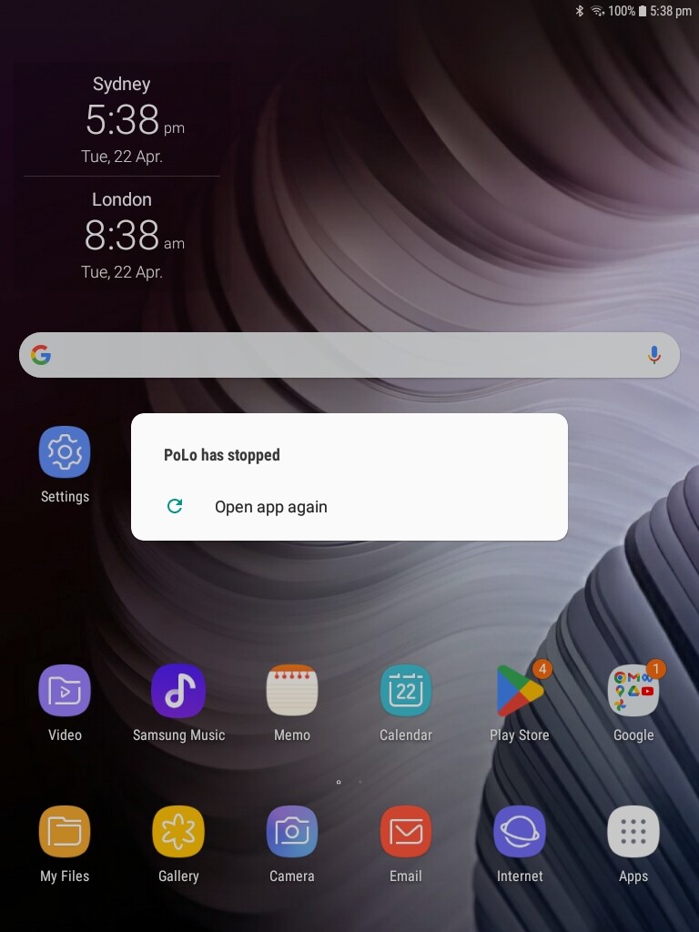

Me too… App (April Version) is not longer working on Android 11 and Android 13.
Me too, Galaxy A13 Android 14. Anyone notices that all devices reported are samsung? I have the app on other devices and it works fine.

App shuts down and leaves message about fixing the bug on Android phone Galaxy A13 5G 64GB

We’re preparing a special build of the app that hopefully should work on devices with 4GB of RAM or less, which seems to be the root cause that causes these crashes.
