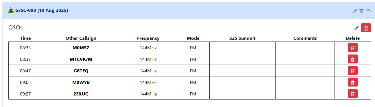

However, I need to report a small issue. I’m using the August 2025 release and recently did an activation. I then exported the “full” ADIF and uploaded this to SOTAwatch. When I verify the log before committing, unfortunately, the RST_SENT and RST_RCVD data seems to be missing:
Should this data be in the “Comments” column?

Am I doing something wrong? I’ve uploaded a couple of ADIF files last year and that seems to include the signal report data automatically…
If anyone has any ideas…? Of course, I may be expecting the ADIF file from Polo to automatically be compatible with SOTAdata, and maybe it’s not???

Go to General Settings|Export Settings, then tap SOTA activation (ADIF)
Enable Custom Templates
Then in the ADIF QSO Comments field either leave {{qso.notes}} and add the following, or remove it and replace it with
{{qso.our.sent}} {{qso.their.sent}}
as per the suggestions you see at the bottom of the Settings Page
Thanks @VK1AO - much appreciated! I guess the template got changed somewhere along the line as I don’t remember editing that myself previously. Anyway all sorted!
