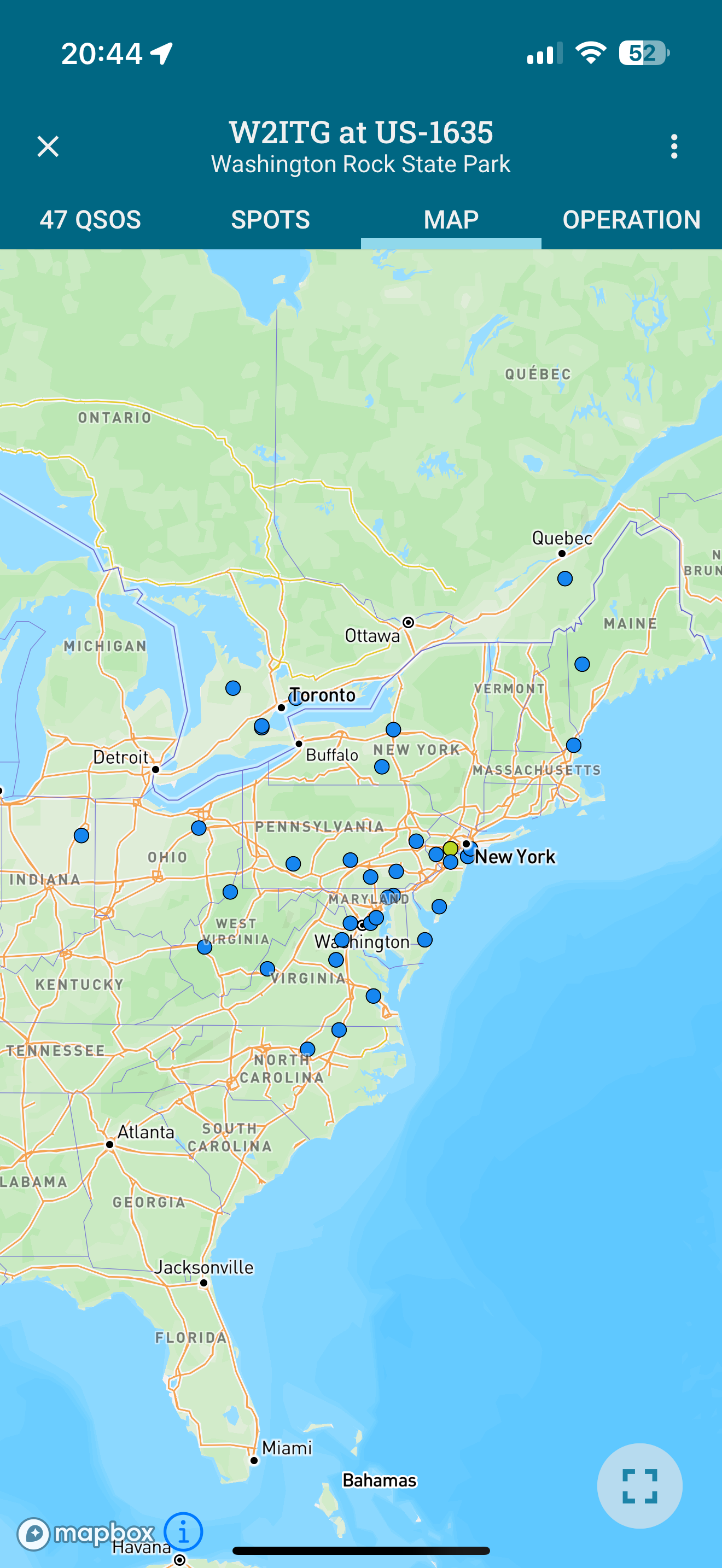

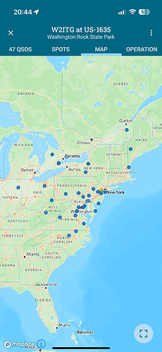

So on my iPhone & iPad on the latest beta the map isn’t working properly in that the lines aren’t drawing on the map. I’ve also noticed that the dots are no longer sized based on the signal strength. On my iPad I was able to revert to a previous version then back to the latest beta and the lines are drawing, tried the same with my iPhone and the lines still aren’t drawing. On my iPad every time I come back to the app after it’s been opened it flashes twice between light & dark mode screen. I have it set to device scheme (light during day & black during night).

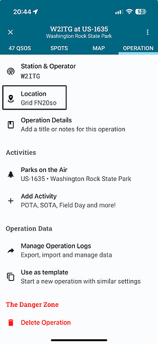

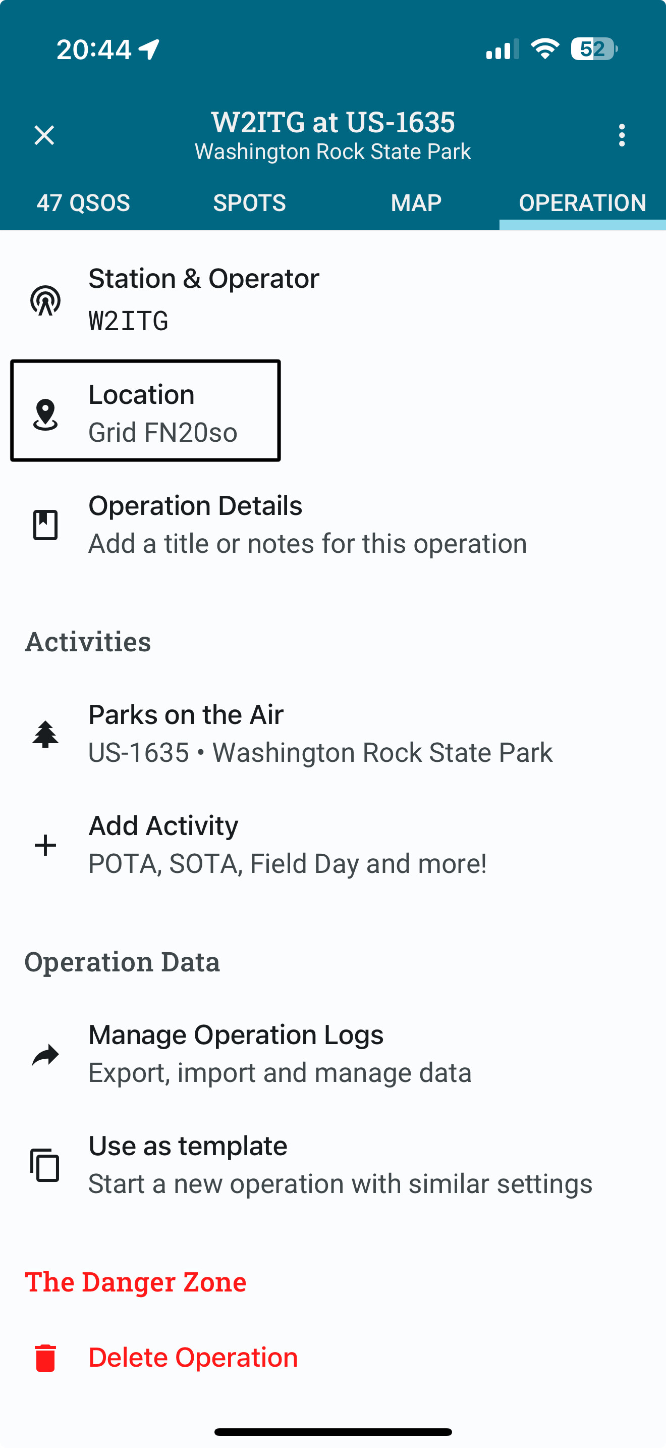

As far as the lines are concerned. You say no lines on one device but lines on the other.
Can you confirm that the device with no lines actually has YOUR gridsquare set for the operation in question?
Yes here are some screenshots.
OK then I have no ideas. You have Mapbox which is the new version. You have your own grid and obviously the other stations have their grids which are not just country or state specific.
