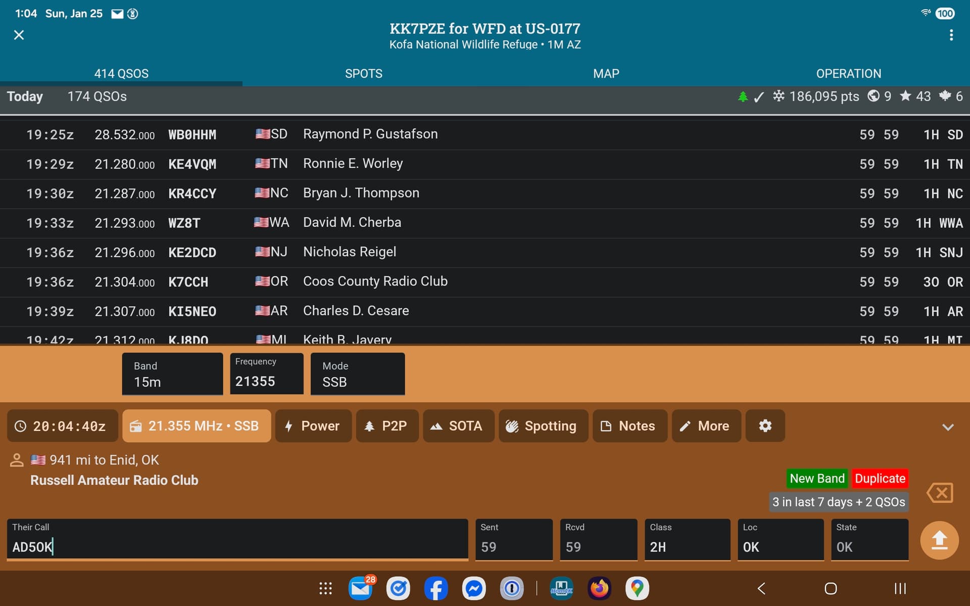

Running on Android with the latest release. I just finished doing a POTA/WFD weekend. One thing that was a bit confusing is I’d get a red flagged item saying duplicate with a green flagged item saying new band right next to it for some contacts that I’d previously worked. I confirmed it was a duplicate so I’m not sure why it was saying New Band. I’ll attached a screenshot and if you need the log, let me know. Or, maybe I’m just not understanding something. Thanks!
PoLo is evaluating the contact for both POTA rules and WFD rules.

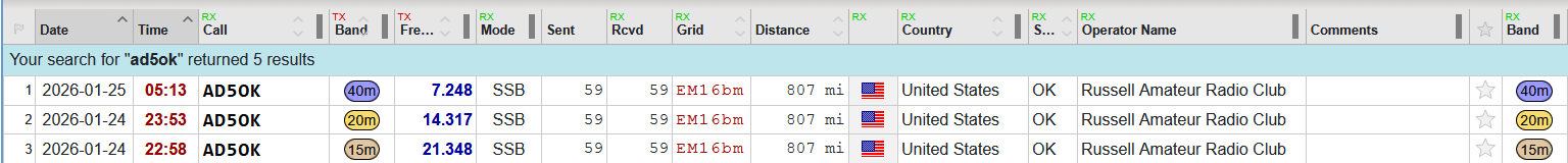

What other contacts do you have with AD5OK in this operation?
Sorry for the delay. I just got home from camping at the park. Below are the contacts. Thanks much! Joe - KK7PZE
