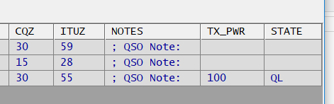

Hi Alan, I want to record my TX power so that it appears in my main station log when I export the ADIF file from PoLo. I can see how to add it to an individual QSO but I don’t find that it is sticky - it does not appear for the next QSO. Have I misunderstood something here? My goal is to be able to set the power as a fixed figure for each Operation.
It certainly is “sticky” if you add the power control to your input area.
If you only add power to the “more” info, it is not sticky.
Use the cog to add power to your inputs
