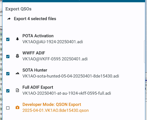

Can you give us some screen shots of how you set the activations up?
I do this exact same thing and have done for well over a year now. I have no issue with it.
When I tried to export the logs, all four parks had check marks beside them.

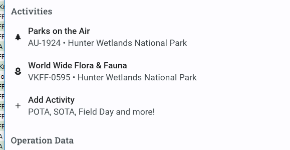

This doesn’t happen unless you add the parks into the activation. This is my latest one yesterday
and I get this as the possible export option
You may have misinterpreted the logic of “Operations” in PoLo.
One operation is one operation which may have 2 or more activities associated with it.
If you move to another park(s), then you need to create a new Operation. You cannot continue adding QSOs into one operation after adding two more parks to it. You will in effect be creating an operation with 4 parks. The 4 parks will apply to all QSOs.
Make a new operation for each activation you do.

When I looked at my screenshots, I can see the error. Somehow, I managed to add a POTA park and a WWFF park that are closest to me in addition to the desired parks.
Sorry for the false alarm. Funny how you can’t see the forest for the trees at times.
This subject is resolved.
