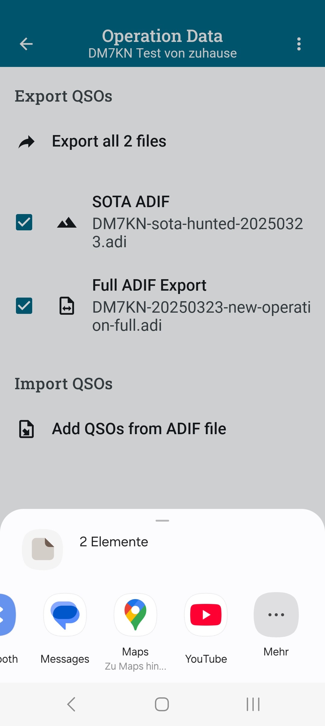

This is shows the screen on my Android Samsung phone:
Only apps for sharing are presented and the “…more” button only shows further apps of the same kind but not e. g. the file manager.

Polo can only offer what the operating system allows.
I think your best option is to install Files by Google - see the posts you mentioned above for the link if you need it.
I think most people use a cloud service to share to so it’s immediately able to be picked up on other devices/desktop setups.
