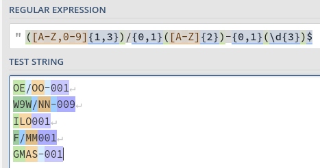

Btw. it would be great if this would also work for the summit references as the automatic recognition (formating of the S2S ref) is not working very well.
But I guess it is in the Regex for recognizing a sota reference. A search from the “end of the string” should work better.
  • Always 3 decimals at the end . \d{3}$
  • Add a dash before that if not there already
  • The region always has always 2 letters (non-digit) A-Z]{2} (always the last 2 non-digit)
  • Add the forward slash before that
  • Everything before the slash is the association (it can contain A-Z and 0-9 with {1,3} )
Not an regex expert but something like that should bring the propper groups?
So all variations with or without the / or - should give a group of list of 3 with Assoziation, Region, Summit number

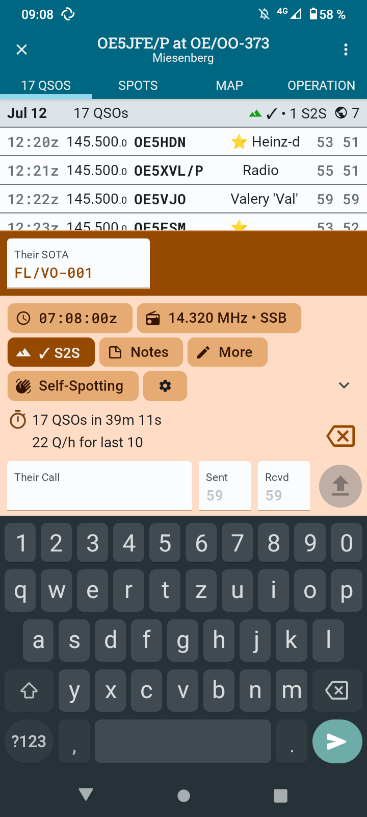

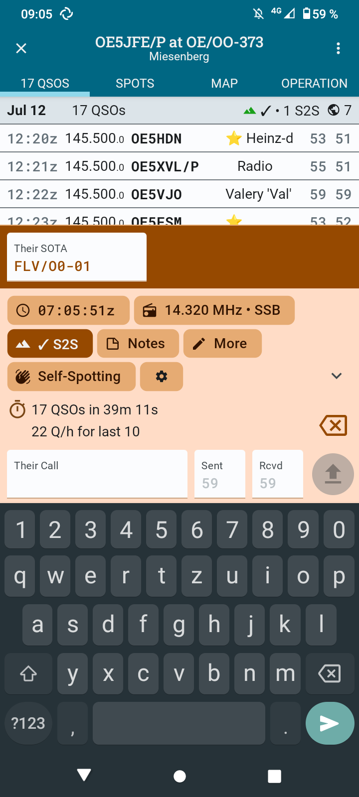

It is not a specific reference. It is a timing issue from my point of view.
Quickly typed FLVO001
Slowly typed the same FLVO001

Thanks - I can make the same comment about entering POTA reference numbers. Typed normally on the simulator the reference prefix is inserted correctly. Typed normally in the field where internet latency is higher, the prefix codes are often not inserted. Typing very slowly can fix it, but not always.
All the data that I put in the field is obviously visible (so nothing is lost). But the assessment and reformatting kicks in too late ( or too early) or incorrectly?
