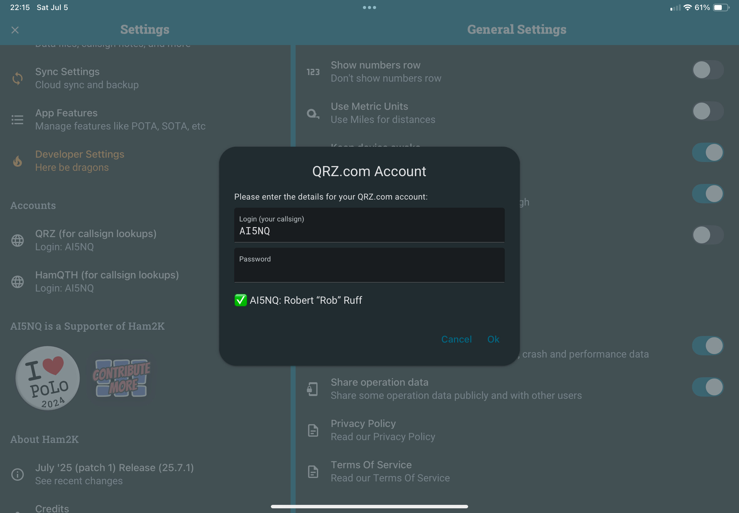

Yes that is how I’ve always had it setup. This is what I see on my screen:
I can export the POTA log but nothing happens when I click “export 1 selected file”

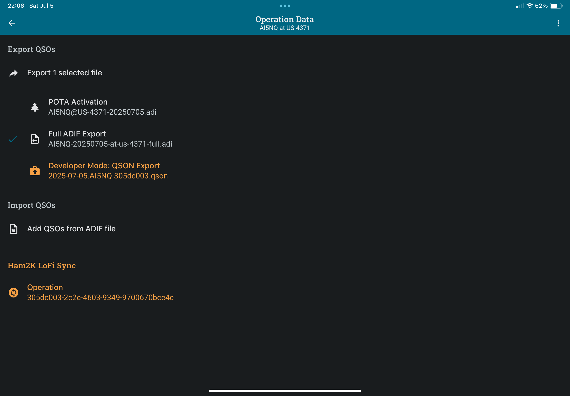

OK then since the update, did you ensure that your QRZ login was current?
The credentials may have expired.
And when you have both ticked and it shows “Export 2 selected files”… Do both get exported?
When I check my credentials, I do not end up with a blank password field.
Do you have a password set?
Yes when I take a screenshot by default my iPad removes the dots from the password field. Apple AI.
No. Neither one gets exported if I have both files selected. I can click “export two files” but no dialogue box pops up to allow me to save it.
OK then we need the qson file.
Found the problem. It was a bug with the export support on the Satellite Extension.
I’ve fixed it, and will go out with 25.7.2 whenever it gets published.
@AI5NQ in the meantime you can remove the Satellite activity from the operation and it should export just fine.

I will update on the next activation sometime this weekend. Deselecting satellite ops did work like you had said it would. I conducted an activation on 7-7-25 and was able to generate a POTA adif and a full log adif.
I went to a park today. I was able to export both the POTA log and the full ADIF. I had satellite ops and POTA selected as the operations. The full ADIF had everything except my county and state, which is what I add through ADIF Master (easy peasy), before I send it to LotW through TQSL.
