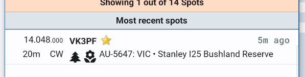

The spotting page does indeed carry multiple parks for an activator. This is an example of 1 POTA and 1 WWFF. When 2 or 3fer POTA are being activated, the number of POTA trees will reflect the number of parks
When an activator is on a SOTA summit it will show that information as well - a summit icon.
When you tap on this spot, your log entry is prefilled with all the references.
PoLo also provides for backfilling a QSO. If you edit a QSO and there is a current spot for that person containing references you do not have, PoLo will back fill the references into your QSO.
This can be done from spots which are posted “correctly”. But PoLo can’t invent this information from nothing.
